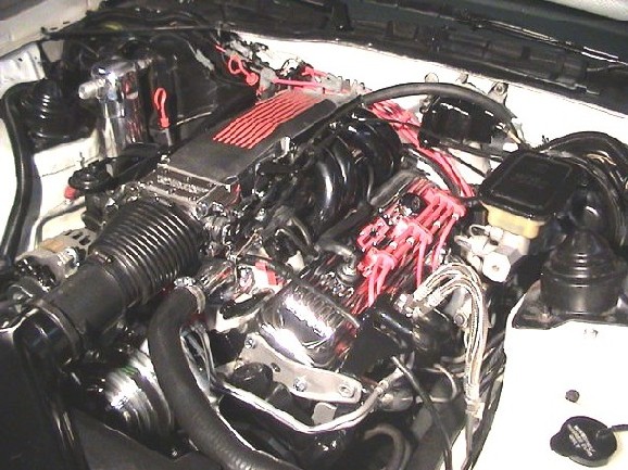

alright guys..here it is, ready to come to life after almost 7 months of pure agony!.....I bumped the key over and it sound like it was going to crank.......im scared!!!!...LOL!
ITs still sitting up on all four jack stands...

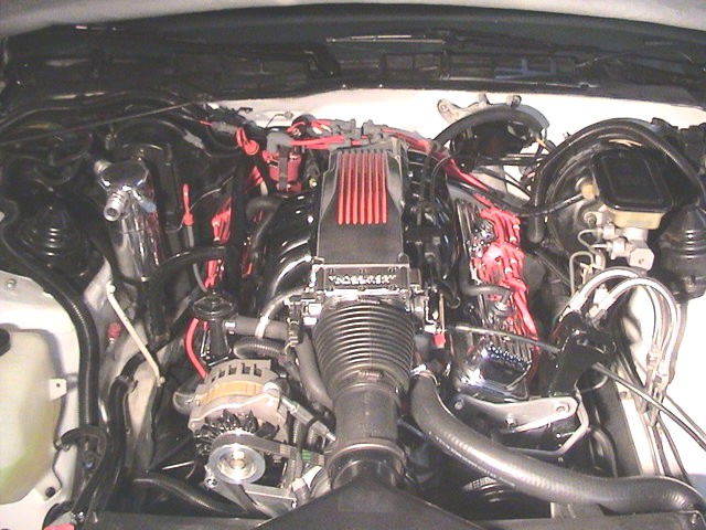

somebody come over here and crank'er up!!!!...I cant take it!
I guess I shold wait til I get the custom chip for it..huh?
hey....the A/C condensor....can I just cap that off til I put the hoses back on it?....

Not sure of all the mods you've done, but if this is a fresh engine, I would wait. If not, it'd be ok to drive it over there. Just watch out for the popo.
The best sound to me is a fresh engine cranking with open headers...
*HUFF-HUFF-HUFF-HUFF* then the oh-so-sweet sound of open headers :hail: :hail: :hail:

BTW, your setup looks REAL nice.. I like how everything turned out!! I really dig the wire looms.. Looks very nice as a package!

thats one pretty engine
