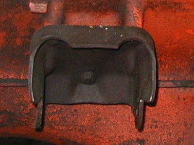

Riley's35089rs+,
I usually refer to the piece in the photo that you attached as the " engine Brackets"
Here's a picture that Powermite posted on another thread and the "clam shells" are the bracket that are bolted to the K member.
Bruce
Bruce
