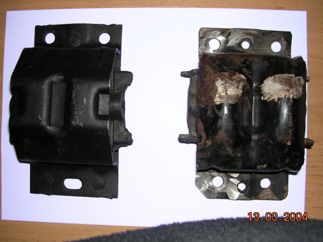

Ive been trying to buy new engine mounts for my 85Transam but with no luck.
My GM dealer here has sent me what he says are the correct ones for my car but they are nothing like mine.
Have a look at the pic and tell me which ones yours are like
thanks

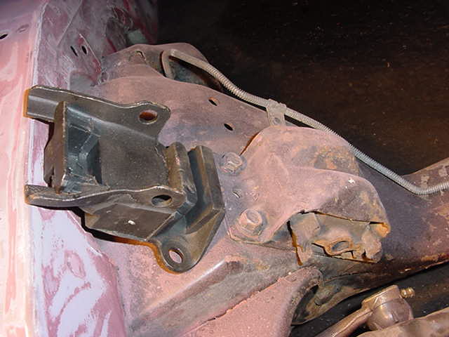

Looks like the one bolted to your crossmember right now, or this:

Your GM part# is 22188497. Assuming it's a V8. Your guy either looked it up wrong or it's mislabled.

now these are the one they sent.Similar style but the holes dont line up.
The dealer tell me they are correct but i know otherwise,Why is there a slotted hole in the bottom whereas mine uses on of the outside holes,that arent even in the new mount.And even though the top two holes look right they dont line up with the holes on the crossmember
The make on the box is Anchor part#2387

I think i can answer my own question here.They are 2nd gen transam mounts.

well he must have terrible eyesight because the first pair he sent were 1st Gen
