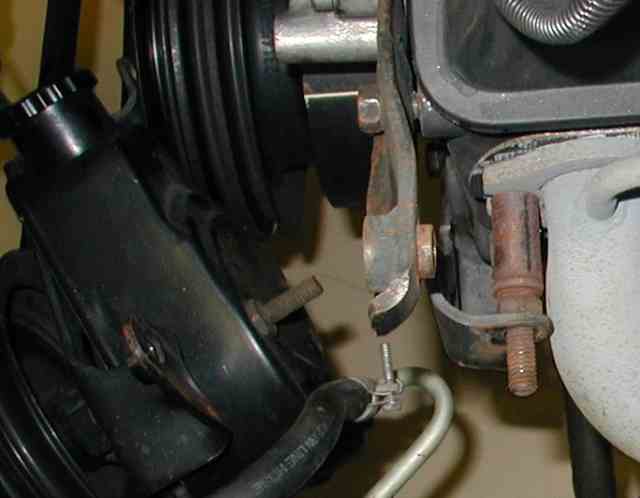

Here's how the one fits that goes across the front.... It goes on the manifold bolt, and goes down to the front of the block

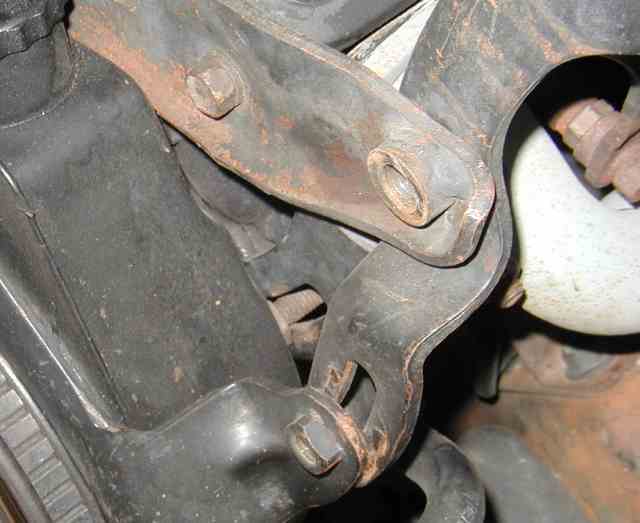

Another....

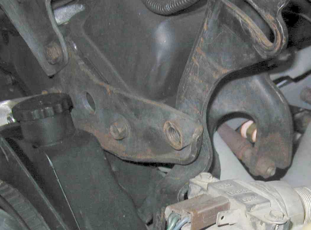

Then some of the others go on the front of the head

Here's how the pump goes on

you are the man. WE HAVE A WINNER!!!
:hail: :hail: :hail: RB83L69 :hail: :hail: :hail:

one last question... how big was that spacer you used, and how did you make it?
Old Mar 3, 2004 | 10:26 AM
RB83L69's Avatar
Posts: 18,457
Likes: 16
From: Loveland, OH, US
Car: 4
Engine: 6
Transmission: 5
Couldn't tell you how big it was.... it came with the headers, but was the wrong length (too long); I set the header and manifold next to each other, and cut the spacer to be the difference in thickness between the manifold and the header flange. Then I used the stock hardware; the stud, all the washers, etc.
You could easily use a piece of steel pipe with 3/8" ID as raw material.
