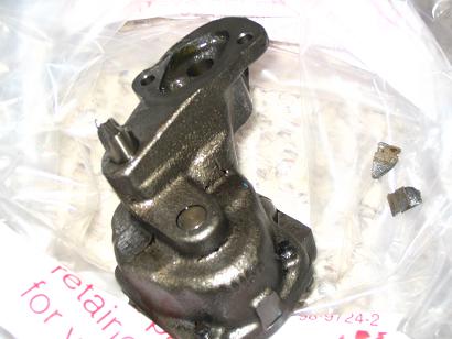

I had the plastic collar break off my oil pump/driveshaft a few months ago. Seems to me, the driveshaft slid out of the slot, got out of alignment or jammed on the block or something, and because of that, it snapped both sides of the groove off the top of the oil pump shaft. Broke them clean off. Don't beleive me? Heres the pump that came out:

Air_Adam,
The plastic coupler didn't cause that.
If it was REALLY important it wouldn't be made of plastic.
It is actually a 'guide' for the pump shaft to simply hold the shaft in position until the distributor is installed.
Once installed the distributor 'bore'is VERY rigid and the distributor shaft cannot 'wobble' around.
The pump driveshaft CAN'T jump out of position once the distributor is installed.... collar or no collar.
Something got in your pump or something got into the cam/distributor gear and jamed it up.
Take the pump apart and see if there's something stuck in the gears.
Examine your distributor gears for damage.
Something OTHER THAN the plastic collar caused that to happen.
