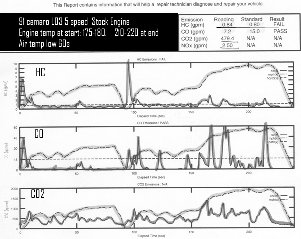

Emissions: Dyno Graph pic, need help
My LO3 stock 5 speed failed the IL Air Team emissions test.
CO= 0.84 gpm
NO = 7.2 gpm
CO2= 479.4 gpm
NOx= 2.50 gpm
From the Graph (2nd post) it seems as if my HCs and Cos are spikeing when the shifts are made, not really apparent on graph.
What are the problem areas i should look at?
BTW: 1/2 tank of 87 Octance with 3 bottles of HEET when tested

The massive spikes are in 1st gear from a dead stop. Indicator of something?

The spikes on acceleration and decelleration are normal. Your cat is an aftermarket performance cat right? That could put your car over the borderline. One quick thing to try would be too create a small vacuum leak. That might help drop the hc's a little. Another thing to do is to make sure your car is good and hot when you get there.

The spike on acceleration and decell are normal. When the gas is pressed fuel is added along with the extra air. In our cars the enrichment is slightly more than needed thus the spike in co's. The same is true for decell. When the throttle blades close there is significantly less air in the intake but it takes a fration of a sec for the cpu to realize it and the injector shuts off late causing a rich mixture and increased co's.
