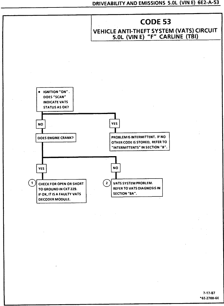

Hello Savannah Dan,
The codes for your car are as follows:
Code 32= Exhaust Gas Recirculation (EGR) Circuit.
Code 44= Oxygen Sensor Circuit (Lean Exhaust Indicated)
Code 53= Vehicle Anti-Theft System (VATS) Circuit.
The temp gauge going up when you turn the key to start is normal.

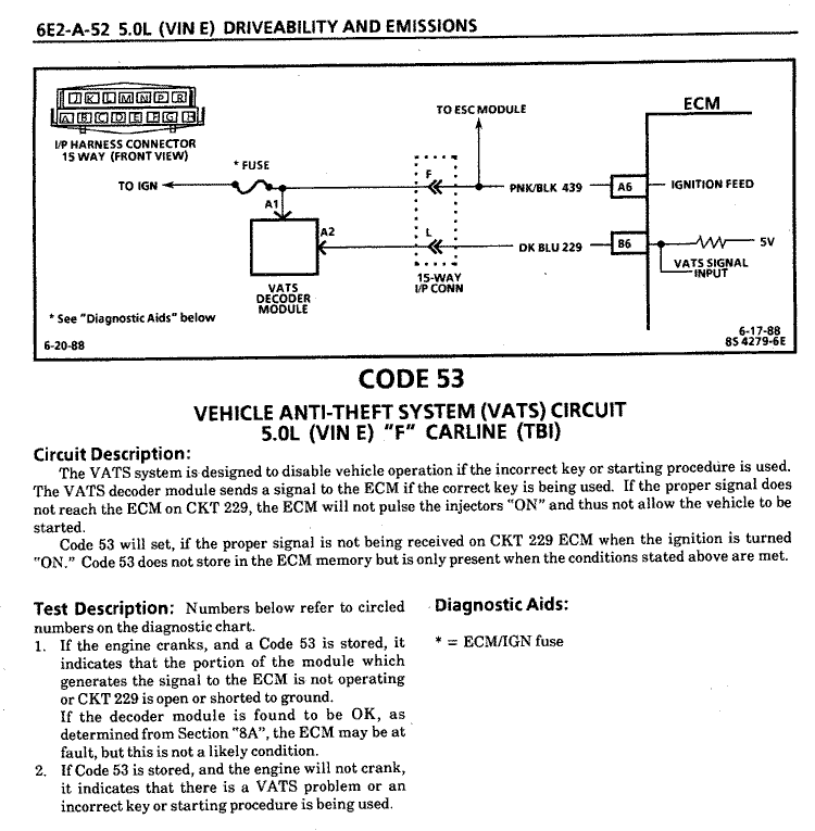

page 2

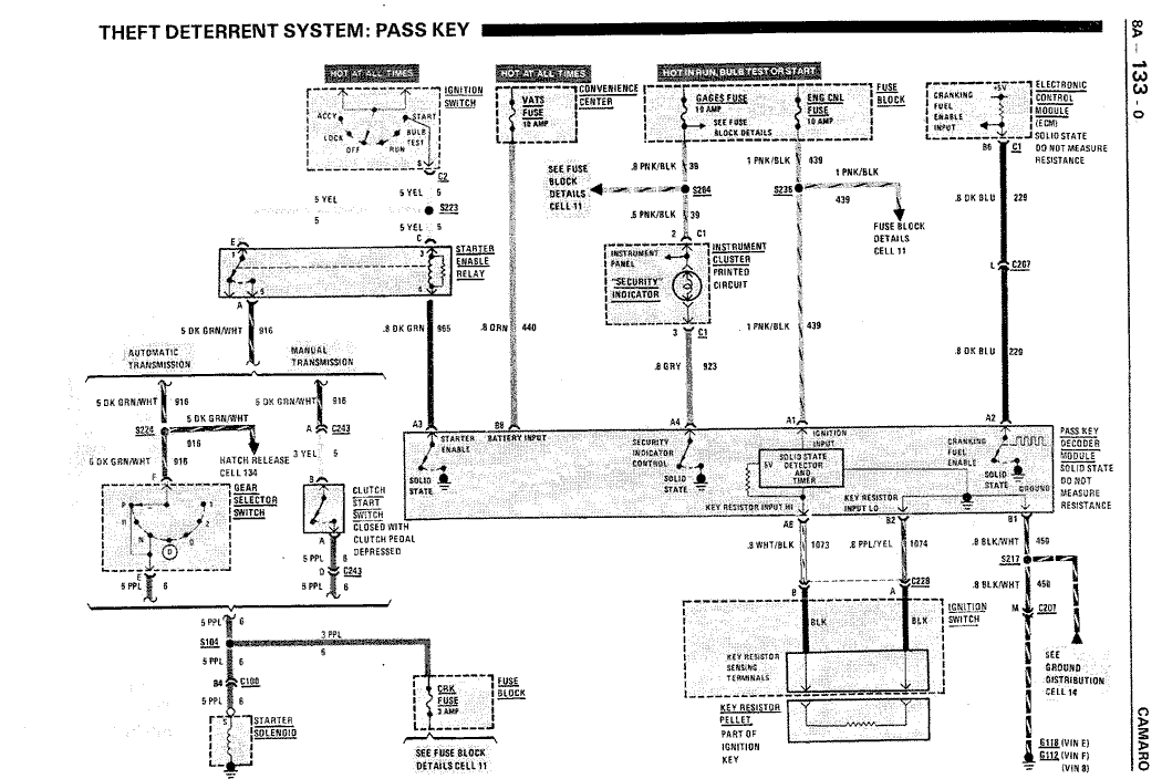

The VATS control module is located beneath the defroster ducts on the firewall behind the center console. That unit very seldom goes bad, it is probably a broken wire on the ignition lock cylinder in the steering column. Use a multimeter set to OHM's and measure the resistance value of the pellet in the key. Under the dash, you will see two wires coming from the steering column. They will either be two yellow wires in a black wrap or two white wires in a orange wrap. They will connect to two wires that are black/white & purple/yellow. Disconnect that harness, put the key in the lock cylinder and measure the resistance value through the wires in the steering column. If the value is different from the first reading, your problem is in the lock cylinder. If the value is the same, your problem is elsewhere in the system. I am including a schematic of the VATS system. No, there is no procedure for re-setting it manually, it has it's own built-in re-set timer. And yes, I agree about the Haynes manual as well as the Chilton. That is why I spent the extra money and got the GM service manual for my car. It was well worth the money spent.

Ok, spent some time under the dash today and spent some more time researching the wiring. The "two white wires in an orange wrap" are labeled with Airbag stickers and everywhere I read it's telling me strictly to NOT probe those wires as it could cause a deployment. I don't think the super low current of a ohm meter would do it, but I don't like tickling airbag wires at all.
Where did you get your info on this? Sounds like something a joker would say to get somone to deploy their airbag... Course I could be looking at the wrong wires all together. In any case, I'd say be extremely careful when messing around with airbag wires, not only could it hurt you, it will also make your car stink and they are expensive as hell to replace (trust me I know).
Well, back to the troubleshooting.
Old May 2, 2004 | 07:02 PM
Trickster's Avatar
Posts: 6,127
Likes: 11
From: conway, s.c.
Car: 1989 Iroc-Z
Engine: 5.7L TPI
Yes, the wires are bundled together on your car with the airbag harness that comes down the steering column also. Look for the two white wires that plug into a connector that has a black/white wire and a purple/yellow wire. These are the two wires for the VATS. The airbag wires should be a solid yellow. The two white wires are wrapped in orange. Here is the only picture I have of it at the moment. This information came out of the GM service manual and I don't think they want a airbag going off in someone's face either.

Got it! You are indeed correct Trickster (not that I ever doubted you).
I was able to verify with a wiring diagram that those are not related to the airbad system. Why they label them as such, I have no idea. I rigged up a 5k pot and adjusted it as close as I could to my key's resistor then attached it to the car side of that plug and it fired right up. Also the other side of the plug (white w/ orange wrap) is reading open with and without the key and in all positions.
So the problem is definately in the ignition switch or wiring to it.
