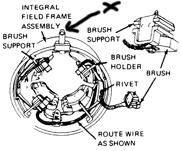

ok im doubting my hook up. How many wires go onto the smaller termianl on the solenoid, i have one wire there and the other one, the 2 that merge into one, hooked up to the larger terminal , the same one the battery hooks up to, is this correct? are there any diagrams that show the actual hook up?
Old May 7, 2004 | 10:54 PM
Trickster's Avatar
Posts: 6,127
Likes: 12
From: conway, s.c.
Car: 1989 Iroc-Z
Engine: 5.7L TPI
There is only one wire that goes to the small terminal post on the solenoid and about 2 - 3 small ones that go to the big post along with the battery cable. Do you have that tang on the starter connected to the bottom section of the solenoid.
