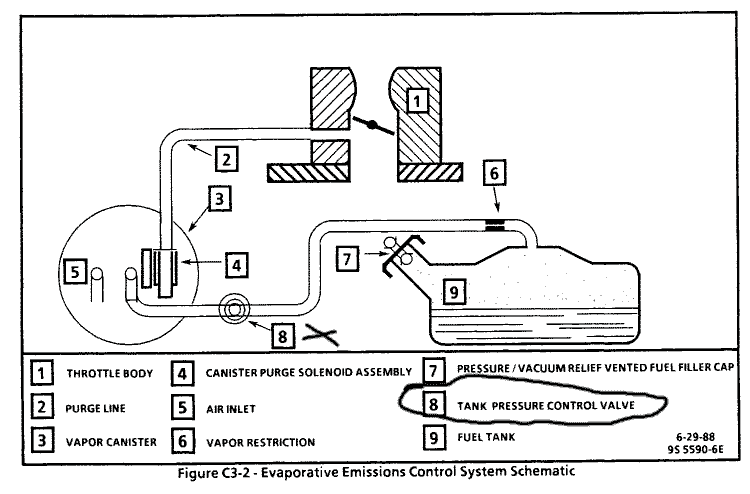

The item that you want to check is the fuel tank pressure control valve located in the small 1/4" line just back of the fuel evap (charcoal) canister. It is item #8 in the second picture.

My purge valve was on backwards!!!!
Hey trickster, thank you so much for the info. If your ever in Toronto, Ontario, let me know and I'll buy ya a beer. Thanks again.
