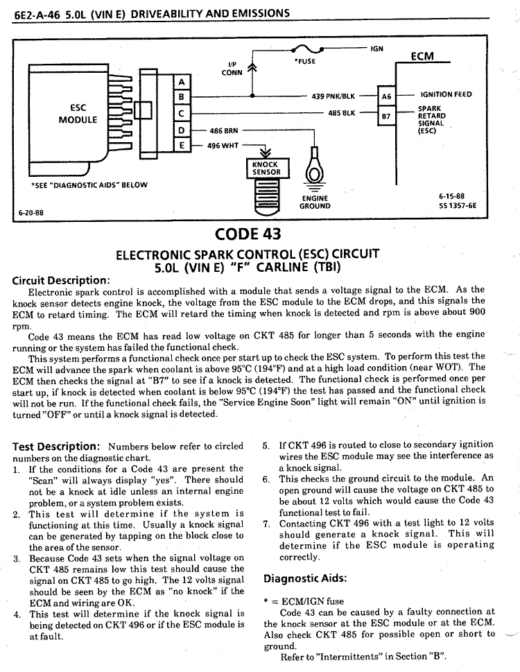

The wording maybe wrong, these are the words from the dealership. "I found code 43 -knock sensor module circuit- I tested and found the knock sensor module was not seeing a trigger all the time and the knock sensor had high resistance."

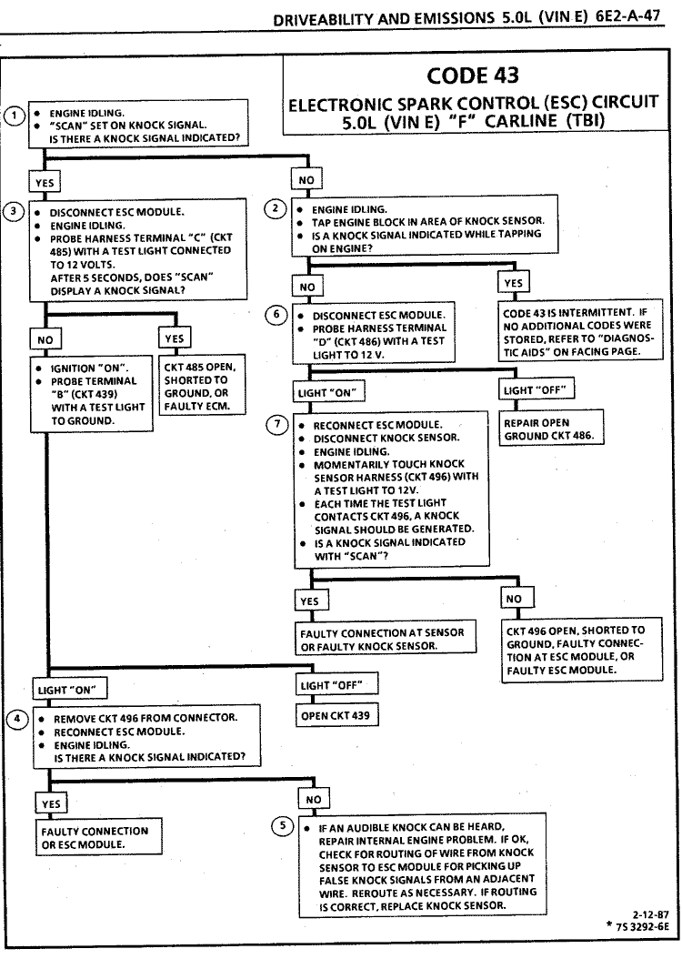

Here is a troubleshooting chart for you to look at. Another board member who was having a similar problem found a broken wire going from the ESC to the ECM was his problem. The wire goes through the firewall on the passenger side to the ECM.
BTW, there is no knock sensor control module on our cars. You will notice in this chart that I am sending you, that the knock sensor is tied into the ESC. That is the control module they are talking about, just bad terminology on their part.

From the ESC module's point of view:
knock sensor wrapped in paper towel with body not grounded = disconnected, even if the wire is plugged in
That's why you're getting the code. AFAIK the ECM doesn't do a "test" of actual knocking; i.e. advance the timing until it hears knock or whatever.

k so here is the latest. I tried to follow the wires from the ESC to see if they were either grounded out or drawling current from another wire. Coulnt really see so I cliped two wires from the ESC, the ground wire (brown) and the white wire (goes to knock sensor) I wired the knock sensor to the ESC with my own wire that is less then a foot long. Grounded the ESC ground wire to a ground point over there near the ESC itself. Messing around with these wires and the other two from the esc (pink wire 8 Volts, and black wire 12 Volts) On random starts the check engine light would come on. Sometimes after the 5 seconds sometimes after much longer. Everytime I would test the voltage to the Pink wire the check engine light would come on, and possibly for the black wire also. Both with error code 43. I started to follow the pink wire to see if it was possibly grounding out somewhere but didnt see much after pulling on it a bit to see where it was going. The last time I started the engine the check engine light didnt come on, reved it up quite a bit, started taping on the knock sensor which was just laying there and no error code. Drove it around romping on it quite a bit which before would for sure pop up that error code, the code didnt come up. Stopped at the cornerstore shut off the engine, started up drove around more with heavy acceleration, still no error code and no timing readjustment. Maybe there the black or pink wire was grounding out somewhere? But this doesnt prove anything yet, I'll have to drive the car for long distances before I really know if this has solved it, if not I'll probably clip the black and pink wire and just rerun new wires to the ECM. Its just to hard to find shorts in those wires that go behind the engine and through the firewall.
So the Knock sensor should be grounded? the metal sensor itself? ok well I'll ground it if that code pops up again. Do you think the readings below are corect?
Voltage test while idle at the ESC
Pink wire= 12V (ignition)
Black wire= 8V (Spark retard signal wire)
Brown wire= 0V (Ground)
White wire= =V (Knock sensor)
>With the check engine light on or off the voltage stayed the same
