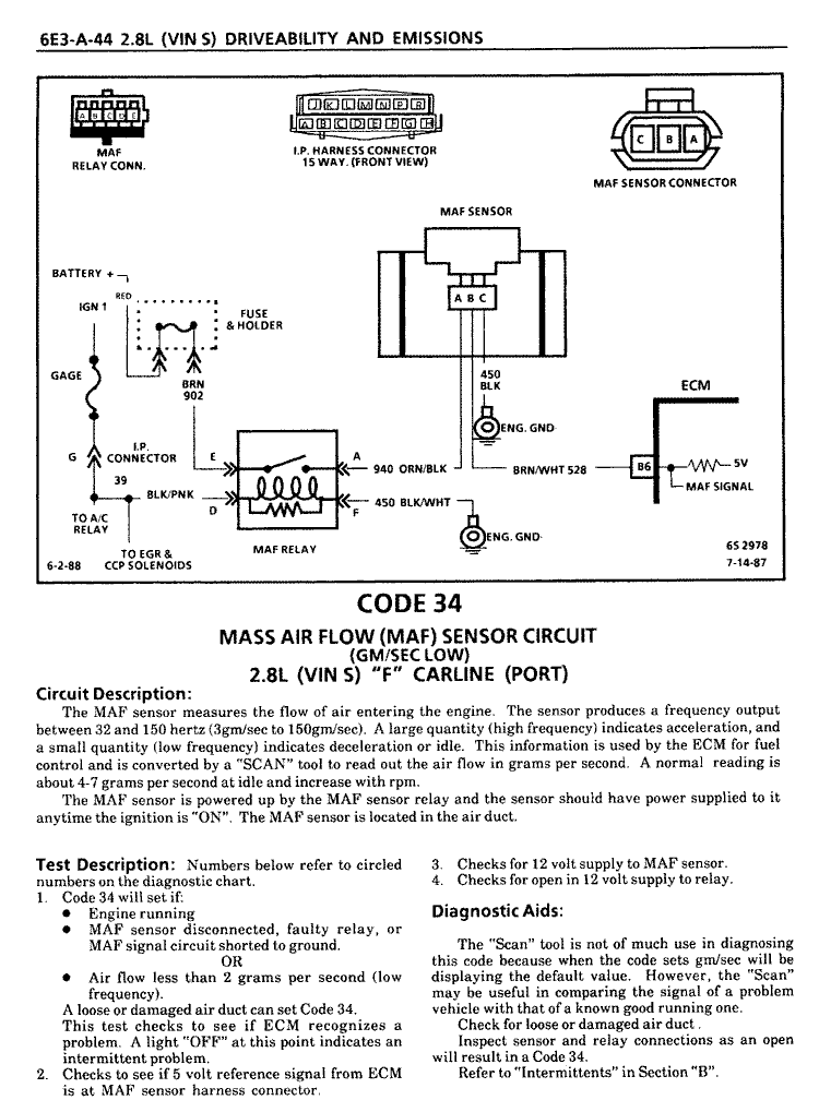

MAF Voltage is too high I don't know how to lower it??
Could anybody tell me how to adjust it?

Just curious here, what indications are you getting that tells you your MAF voltage is too high? Are you getting a code 33 or 34? If you are, that indicates that the MAF is registering either too much or too little air through it. BTW, the MAF voltage is not adjustable.

I am getting code 34.

Okay, check out this trouble shooting chart and see if it helps you any.

The tps sensor will also trip that code if it is out of adjustment, check your voltage. Mine will trip the light if it is higher than .62.
