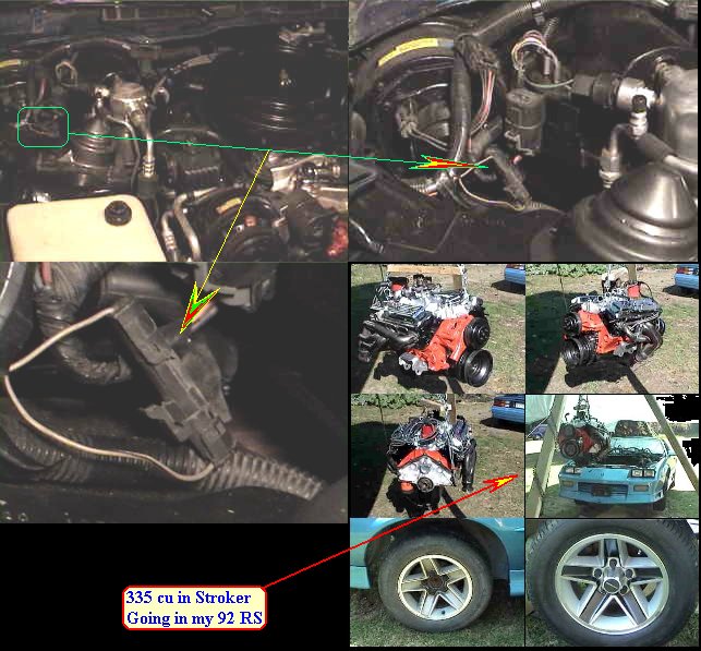

thanks, now the only problem is that the repair book I have said something about separating a wire before doing that and connecting it after. I have no idea where it is. The book had a picture, but it didn't seem to help.

Timing Problem
My Chiltons shows 6 degrees BTDC for both VIN H & F on the 87 305. Idle for VIN H is 700 RPM if you have the manual trans & 500 for the auto, VIN F is 500 RPM for either. The wire they are speaking of is a brown with white stripe hanging out of the harness back by the blower motor on the passenger side. Just unplug the connector while setting the timing & reconnect it when finished. It also states that for all feedback carb systems to disconnect the 4 wire connector at the distributor.
Good Luck,
Simpleman
