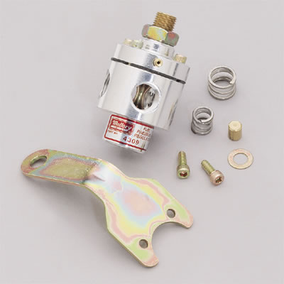

this is the regulater i have. sorry a little mess up on the model number. that 140 5 is the number for my carb. lol.
Attached Thumbnails anybody else having problems with the mallory fuel pressure regulateR?-maa-4309.jpg

ok guys i got the guage. and my pressure is above 15(the guage only goes up to 15) lol. so i gotta do somethin about that to bring it WAY down. mayb the return line will help
Old Jun 1, 2004 | 09:08 PM
Damon's Avatar
Posts: 7,072
Likes: 13
From: Philly, PA
I have that same regulator and I'm going to be putting it on my 92 RS when I convert from FI (305 TBI motor, originally) over to carb in a week or two. Not my first time doing something similar to this, but my first time using the Mallory regulator.
The return line does come out the bottom/center of the regulator. That gets connected to the stock fuel return line in a manner similar to how your fuel feed line is connected to it now. Your car originally had 2 fuel lines coming off the driver's side strut tower. A larger 3/8" feed line from the pump and a slightly smaller 5/16" return line going back to the tank. The return port on the bottom of the regulator gets connected to the stock 5/16" return line.
The difference between having a properly functioning return line and just dead-heading the pressure against the regulator is night-and-day. I've done stuff like this several times and using a high pressure FI fuel pump feeding a low pressure carburetor absolutely requires running a return-style regulator/lines.
Once you get the return line hooked up and functioning properly your fuel pressure readings at the carb will act much more "sane."

UPDATE!!!!: its fixed. my mistake. darn return line. hooked it up and the guage read 6 psi. i was so happy. i love this site:hail: :hail: :hail: :hail: :hail:
