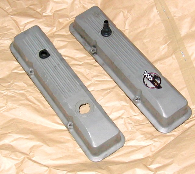

That pic finally loaded.... no, I don't think a 305 has that (or any other LJ motor for that matter, IIRC it went with that change), but there may still be enough metal back there to drill something that would work, if you went about it the right way.

I have thought about newer Corvette valve covers (pre-L98 perimiter bolt, same style) but its really hard to find a decent set on Ebay.
I like the LT-1/L82 valve covers too... the ones the '69 Z28 had, but a pair of those in any condition are WAY too expensive.
I really like those '67 style ones though. Would it be possible to put a PCV hole in one of them (hell, they aren't original anyway) on the side that faces the intake manifold, and then have a baffle welded in? Or would that not work?
