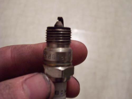

Post pics of the old plugs!!! 3-8 mpg on that set up sounds like you are hemorrhaging gas in the carb. Blowing lots of black smoke when you hit it? I'd start with a carb rebuild and new intake.

I threw away the old delco plugs but I got a pic of the bosch I took out last week.
What do you mean by hemorrhaging gas in the carb?
The carb is a brand new Edelbrock in like the last 2 months. I had several other carbs on and had the horible mileage with them too. Two different Q-jet's, and a Holley 1850. And yes it does blow smoke when I floor it.
