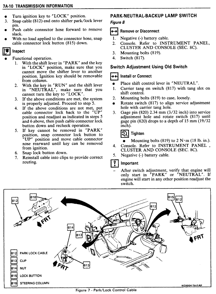

i just switched columns in my car because of wobble, got all electronics done and now i have a spare part, everything works in the car, i dont get it....what is this thing ? i took it out of my old column and cant find a spot in my new one

That looks like the steering wheel lock cable. The other end should connect to the shifter.

but my new column doesnt have the spot my older one did, i dont even see a spot......is it when i wouldnt be able to turn my wheel....in like.....park?

That is the park/lock cable that hooks into the ignition switch on the steering column.

Does the ignition work?

yeah everything works trickster, everything on the new column, so i dont think its a big problem

Actually with it disconnected, you can run the shifter through its places with the key out of the lock cylinder. That was one of its functions, to prevent the shifter from being moved out of the park position without the key turned to the on position.

i could do that with the old column though..... i remember not having my keys with me and shifting into neautral to let the car caost down the drive way for a sec, then putting it back into park

Well, I hope yoy don't have any kids because thats whats prevents them little fingers from moving that shifter out of park.
