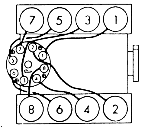

one too many caps...LMAO

Just as ljnowell said, pull the #1 plug, put your finger over the hole and have someone bump the starter over in short bursts until your finger gets popped off the hole. Then look at your harmonic balancer and turn it to 0 deg int the shortest path possible.
Now look at where your rotor is pointing and make sure it is pointing to the plug wire on the cap that goes to the #1 plug. Then be sure that you follow the firing order that has been provided (1-8-4-3-6-5-7-2).
