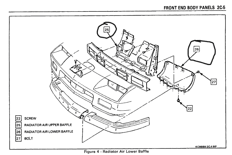

Is the air dam the two plastic peices that hang down?

The two items circled in this picture constitute the air dam as it is commonly referred to.

After seeing other picks, isnt the air dam just one plastic peice??????????????????

These are the upper and lower baffles for the radiator that the air dam forces the air into. Unfortunately my camaro service manuals do not show a picture of the air dam itself as shown in the picture from hawks. On the firebirds they are a three piece affair and are called air deflectors.
