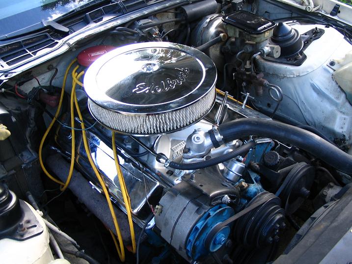

Well, lots of you guys have probably seen the threads about all the $hit I've been going through with this car lately, but it all worked out for the better! I got the oil pump fixed, got it mostly tuned right, and it runs like a top.
I know some of you are gonna knock my choice of intake, but as Five7 always says "run what ya got" and thats what I had. I like it too... low end grunt feels the same as stock, but its got a REALLY nice high rpm howl now!!
Is it really necessary to change the vacuum hose for the brakes to a steel line though?

Nice engine. I think thats the first time I've ever seen the alt. fan painted the same as the water pump/block

Nice looking setup!
As for your question - no, the power brakes vac line does not have to be metal (in fact, I've never seen one that was)

The stock line going to the Qjet was steel up to the check valve, and rubber hose after that.
So it is fine to use just rubber like I did?

id say so thats the way they came from the factory if you replaced the factory rubber line just make sure its as thick as the factory stuff as in wall thickness

AFAIK, you couldn't have screwed that metal brake booster line into the back of that carb anyway, so it's a moot point. Rubber hose is fine.
Looks nice!!

Is your engine supposed to be blue? I thought they were supposed to be black, tho I did paint mine orange like an old chevy

That looks better than stock for sure! Now you need to put on your headers and get something to properly route your spark plug wire.

Your gonna melt your spark plug wires.

Nice! just get rid of that paper edelbrock air filter and get you a nice K&N

Plug wires have been rerouted, and they are now really purdyful, and won't burn up!
