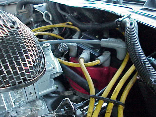

I USED to have one.....I got rid of it when I had the same problems occur.....sudden loss of power and misses, backfires, eratic rpm....
Those coils get hot and that effects there performance.....seriously find your stock coil and replace it with that and see if you problem persists......again I HIGHLY recommend you find a stock coil and convert back....
Here is a photo of the conversion bought to make my HEI a seperate coil pack.....
Attached Thumbnails need help bad, problem went away twice, then comes back-distributer-conversion.jpg

Lose the Accel coil, Im surprised it didnt just stop working all together like it did once for me and twice for my friend with the same car.
