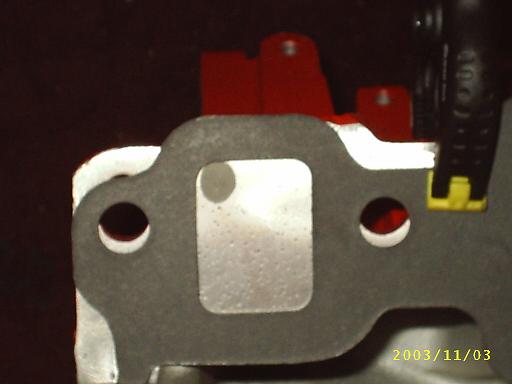

you try lining up the gasket like this before you put the intake on?

yup...always do that to make sure that a piece of material doesn't block or anything.
I specifically remember lining everything up, b/c i was kicking myself for not gasket matching all the ports
i'm going to try to coat the threads with soap or something to help lube them up. maybe. dunno.

the picture above is of my LT1 intake with the gasket properly matched to the ports, you can see how the holes aren't exactly right, my intake was modified by john, he did a good job, but nobody's perfect. However, don't go crazy on the intake with the dremel, especially since you said it looked right when you lined the intake gasket up on it. Check the threads first in the heads, try to put the intake bolt into the head with the intake off.

I'm using a fel-pro 1205, they match the height of the port, but are wider than the stock LT1 port, but then I matched the intake to the gasket. most people use a smaller gasket than that, like a 1204 or maybe the gasket you're using, I just happen to have 200cc intake ports. i'd just check the thread first, if they're messed up it would give you a messed up torque reading anyway, so I always chase the threads before I do anything. I'd just avoid grinding on the intake if at all possible, do that as a last resort.
