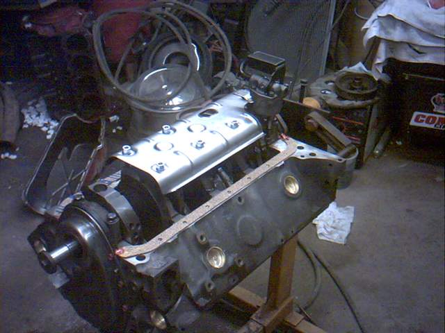

Just an update. Engine is close to being ready to pull. I posted this on another thread, but I figured I'd drag my original post up and throw it here too...
I pulled the intake off, and it looks as if the gasket was sealing great. I also looked into each intake port, and RB83L69 was right, the rocker studs do protrude into the ports!! That's just plain stupid IMO. But I found no oil sitting on the intake valves or anything like that. I guess next step is to pull the heads, and I may as well yank the engine first to make it easier....

Old Dec 16, 2004 | 11:25 AM
LilJayV10's Avatar
Posts: 2,025
From: Evansville,IN,USA
Car: 89' T/A, 00' Firehawk
Engine: 406 Roller
Transmission: TH700R4 w/2800 stall
Axle/Gears: 3.23 Posi
Try GM part number 3927136 Z28 windage tray. You will have to elongate the bolt holes a little to work on a 400. Use the PN 14087508 5 5/8" long main studs. This has worked for me. There are probably other aftermarket trays that will work also just make sure they have the room at the mounting surface for elongating. Something like a Moroso screen tray might not work because the mounting surface is small and doesn't allow a whole lot of room to elongate the bolt holes. I have never used a crank scraper with a 400 but I can't see it being a big deal. Just takes some time to set up the clearance. All scrapers are going to require some trimming no matter what small block your building (save for a 283 or something with a tiny stroke).
Old Dec 16, 2004 | 06:05 PM
Confuzed1's Avatar
Joined: Oct 1999
Posts: 4,211
From: GO PACK GO
Car: 83Z28 HO
Transmission: G Force 5 speed
Hey, thx for the info LilJayV10 -
Well, right now I'm using ARP studs, and I don't think they are long enough. There's only a few threads that protrude past the main cap nuts. And I already have the crank installed and the mains torqued down......so would it still be worth getting longer studs and installing one you think?
The tray you have pictured - I assume it goes on top of the main cap nuts, and is then bolted on with another nut??
I tried the crank scraper thing on my 400 too...I had the same problem you had. The crank throws come way close to the side of the block (it's been clearanced) and there wouldn't hardly be a scraper left when I got done grinding...
Oh BTW....I noticed the cork oil pan gasket you're using...I switched to the fel-pro one piece rubber seal, and I'll never go back! You might wanna try it.
