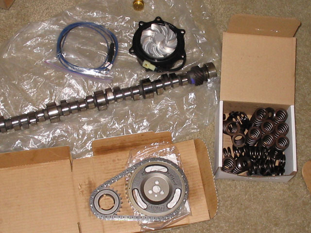

Alright, got everything for the cam swap now.
Electric Waterpump....Check
High Lift Valve Springs....Check
Cloyes Double Roller Timing Chain....Check
CC306 Bumpstick (230 / 244, .510 / .540 112 LSA)....Check
I can't wait to start tearing that corvette *** up with this cam. Anyone know a pretty good way to change valve springs? I've done it before using a air compressor however, i've never done the turn the crank thing. I've taken my balancer off a couple times. Do these go on only one way? I wouldn't want the timing arrow to be off and drop a fricken valve on to the piston.

All together:
Attached Thumbnails Woo hoo!!!  Just got my double roller chain today, im set!!!-all.jpg

Electric waterpump:
Attached Thumbnails Woo hoo!!!  Just got my double roller chain today, im set!!!-waterpump.jpg

Double roller! :rockon:
Attached Thumbnails Woo hoo!!!  Just got my double roller chain today, im set!!!-double-roller.jpg
