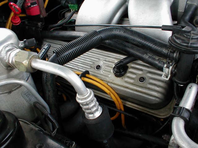

Here is a pic of the Drivers side

Here is a pic of the passenger's side. It does appear to be leaking around the gromet on this side.

Have you cjecked your PVC valve lately? At first glance it appears to be a blow by problem, too much pressure building inside the motor and it's pushing out through the grommets and oil cap.

Those are the wrong washers from what i can see in the pic.

Hmm. I didn't know there were other washers. What do the correct washers look like and where can I get them. Most importantly, will they fix my problem?

I am not 100% sure but i think they are suppose to be copper and you have to replace the bolt, because the washer comes with it and shouldnt come off by itself. Dealer item as far as I know little over a buck a piece

That should solve your problem unless you have excessive blow by

I did a compression test today and the results were good. I also installed the copper washers today so we'll see how that goes. From the looks of the old washers on there they had been tighetened down too often and started to flex up at the outer edges.
