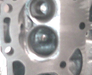

Alright this year I'm going to be running 882 heads. I've gathered that, on this board at least, they are one of the most hated sbc heads ever made. I've attached some dd screen shots in order to show the comparisons between 416 and 882 heads on MY motor, not saying this is the way its always going to be. I know that DD2k doesn't give real accurate numbers and tends to run high, but i should work for a comparison right? I've tried to compensate some for dd being generous by giving myself 500cfm of air flow, and not adding any air flow for the very mild port and polish i did on these heads, or the swirl polished valves.
Another thing I'd like to address is that I've seen a lot of people on here refer to the 882 heads as lightweight castings and the 416's as heavy. My 2 sets are exactly the opposite, the ridge under the exhaust ports of the 416's is "bumpy" and the 882 is the straight design, showing the heavywieght casting.

There is infact 2 different "882" castings the old heavy 333882 and the more recent 882 thats like a 624 casting
Its a lightweight casting. And tends to crack.
Both have 76cc chambers and don;t flow worth a........
A stock 305 head like the 416 doesn't flow any better till ya port them and install larger valves and deshroud the chamber a bit. But the beauty is the small chamber and the fact that they are a dime a dozen.
You can carve and machine it. to what ever size you want. I've finished them to 62cc, 52cc and 65cc before.
I've had 882's , fully ported and modified 416's and vortecs all on the same 350ci short block, in my car. I can tell ya the 882's suck, the vortecs work nice and the ported 416's are right there with the vortecs both flow wise and performance wise "in the car." Lot of bang for the buck.
