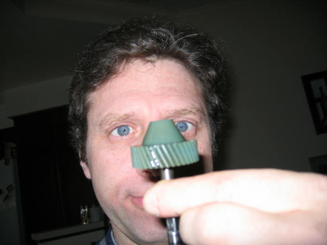

hi guys,
I didnt take the car back to the tranny shop yet
Instead I decided to look at the driven gear to
see what kind of shape it was in.
when i pulled it out there I noticed the tailshaft did not
have a drive gear, uh oh?
So now I dont know what drive gear to get oh boy!
Is there a way to check the case bushing if its bad?
heres a pic of the driven gear it seems to be in good shape
wonder why there wasnt a drive gear wierd?
Take care
Dave
Attached Thumbnails Mechanical speedo cable-c-documents-settings-abc

How many teeth are on that driven gear, what tire size are you running, and what's your rear-end ratio?
Old Mar 19, 2005 | 10:59 AM
HorseflyDF's Avatar
Joined: Jan 2005
Posts: 396
From: Queens NY
Car: 86 Camaro Z28
Engine: 350 sbc goodwrench
Transmission: T-5 in the works
Axle/Gears: 10 bolt 3.42 open
38 teeth on the driven gear
245 50 16 tires
All I know is the rear is a 10 bolt .
Is that wierd?
Why wouldnt there be a drive gear on
the tailshaft.

Is that your stock tire size? There are different drive gears, depending on the overall ratio you need. They're a bit tedious to put on and pull off, so without knowing which one you needed your builder probably just left it off for you to deal with. Either that or he was too lazy or forgot.

yeah thats my stock size 245 50 16 original Irocz rims

This afternoon I jacked up the rear and tried
to figure out what rear end ratio is.
When I turned the rear wheel the drive shaft
turned the same number as the wheel. 1 to 1.
I turned the rear wheel several times and
the shaft turned the same as the wheel.
Now Im confused
Why this is happening?

That's very strange. When your turned the wheel, what was the other wheel doing? turning the same way?
use a grease pencil, put a mark on the tire, maybe on the inside, or on the tread, then put a mark on the driveshaft... then turn the wheel and double check that. The car is in neutral with all 4 tires in the air?

I didnt jack the front why would I have too?
I had it in park first turned the left wheel and the right
wheel turned also for a few times but the drive shaft didnt
turn. So I put it in overdrive and then drive in both cases
they turned together like it was in overdrive I guess.
I was hoping to get the ratio so I could buy the drive gear.

Verify if your car has a posi first. With car in neutral, spin one wheel and see if the other spins in the same direction (posi) or the opposite direction (not-posi). If not posi you will need to stop one of the wheels from turning to get an accurate count. I would spin the wheel about ten times to get a more accurate count of how many turns the driveshaft spins. Divide driveshaft turns by wheel turns. Also, look on the underside of the center console lid and see if the option label is still there. There are a bunch of codes (letters and numbers) in alphabetical order. Post the ones starting with the letter G (ie GT4, G80 etc) to double check gear ratio.

I got the codes GC5 GC6 GU2
I will check again with the car in neutral.

GU2=crappy 2.73 gears. Double check by spinning, but it is probably correct. 2.73 gears take a 38 tooth driven gear (which you have) and 17 tooth drive gear part # 8640517 (which you need). Don't forget the clip for the drive gear part# 6261781. Good luck.

why is 2.73 crappy?
seems ok to me I get alot of torque leaving the line.
I dont know to much about this stuff.
use to drive a *****
thanks
now I can get my drive gear 17 and clip

I got the job done!
There was some play on the tail shaft
but I dont think it was excessive.
I dont know the limits.
There is a gear further down towards the
interior of the transmission. I should of took a pic
at this point. It looks to be part the shaft, shaped like the
drive gear, which was turning a small green gear which
has a metal rod running horizontally threw it,
and theres a round red housing protruding from the
driver side parallel to this.
What is the purpose of this? Maybe thats why
there wasnt a drive gear ,this could very well of
been mistaken for it by a novice I suppose.
back to the job.
Wasnt easy to do the job for a first timer.
Im hoping the last but I may have put
on the wrong drive gear.
It was difficult getting the gear on to the proper
position to get the clip on. If I had fabricated
a better tool for the job would of been easier.
All I had to use was a flat piece of wood and a rubber
mallet to bang on until the gear reached the point
where I could see the original drive gear was by
shadow marks where the 2 little holes are for the clip.
I wasnt sure if I was successful but so far so good.
I was very pleased to see the cable turning finally.
Even though I may have put on the wrong gear its
been quite a learning experience.
Many Thanks
for all those who have answered all my questions!
for the past months!
I have enjoyed the experience even though
I was cursing on many occasions.
take care
Dave (horsefly)

That sounds like the governor, it measures the speed of the output shaft to control shifting.
