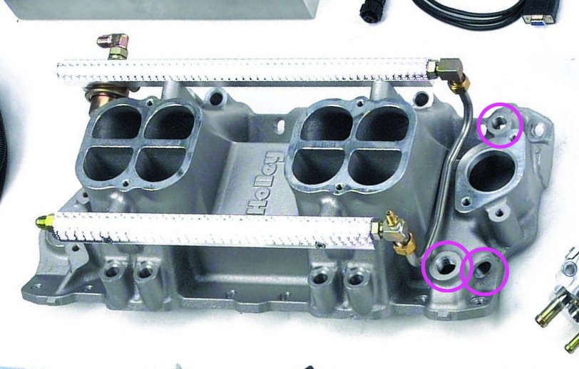

i have a 400 SBC in my camaro and i was wondering if i can T off the lower pass. side sensor location so i can run both knock and fan temp sensor off the same location?

If the knock sensor is not directly attached to the case, it will give erroneous readings.
You might consider a 'T' in the intake crossover instead of the case drain holes.

Yeah that would probably be more wise of me to do that. or maybe i can move my CTS to the front of my HSR and get an adaptor to run the other sensor at that spot or vice versa.

The knock sensor needs to be where it belongs; in the block, where it can hear knocks.
The CTS needs to be where it belongs; in the coolant stream, where it can measure what it's supposed to measure, which is coolant temp. Not cast-iron temp.
Put the KS in the coolant drain hole in the block; and the CTS in either the intake, or the water outlet (thermostat housing) so that each can do its job properly.
The Stealth Ram has enough holes, there should be no problem at all getting all your coolant things in there. Fan switch and gauge sensors go in the heads, where they belong (since they're supposed to measure cast-iron temps); you may need some one of these holes for the heater hose; so you should have a couple of choices.
