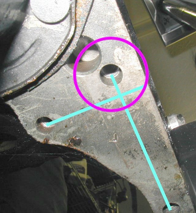

Here's a 400 I drilled. The magenta circle is around the new hole. The 2 cyan lines show how far over it is from the "staggered" hole. Some older blocks have a hole there; but not all that many. And of course it doesn't help in this situation anyway.
If you have that issue, there is NO POSSIBLE WAY to avoid drilling the hole. As I've said before, don't believe it when people start telling you that this or that or the other starter "ought to" work, or "heard" that such and such would, or whatever. The problem is, the later-model starter has to be located about 5/8" closer to the crank than the early-model starter; and that moves the starter motor's shaft over so far, that the bolt that would go in the hole you have, would go RIGHT THROUGH THE MIDDLE of the starter drive.

Yes, they fit the smaller flywheel just fine; IF THE BLOCK HAS THE HOLE. I have one. It's a CVR. It was bolted to the block in the pic for some years, using the hole circled in magenta. It would not have worked without it. 400/T-5 combo in my 83.

Look at the pic I posted. It's a dual pattern starter. With the right block hole in the block, it works like a charm. You're looking at the starter as you would see it in the car, from above, as if the block was clear. OK, now look at the 4 holes across the top, in the aluminum block. The ones that are used for the small flywheel, are the extreme left-hand one, and the leftward one of the 2 at the right. Reason for that is, since the flywheel is SMALL, the starter drive has to be located CLOSER to the crank than it would be if the starter was larger. This combination of holes locates the starter drive in the corret place to mesh with the SMALLER DIAMETER flywheel. Now, notice the spacing between those 2 right-hand bolt holes. Your offset pattern has its inboard hole about 5/8" closer to the starter drive than the left-hand one of those 2 holes. Imagine trying to put a bolt through a starter at that spot, which will be about ½-¾" from the starter drive itself. Have you ever looked inside a starter? It has a big thing inside there, that functions as a one-way clutch. It's usually about twice the diameter of the tooth part of the gear. As you can plainly see, the bolt would have to go RIGHT THROUGH THE MIDDLE of the starter drive, in order to do what everybody wishes it would do. That's why it won't work.... not because "nobody makes one", but rather, because the guts of the starter are in the way.
