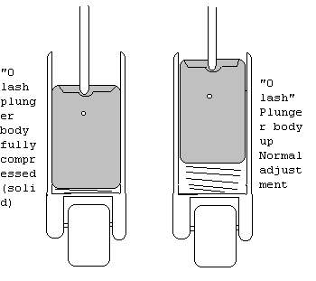

F-Crazy like a lot of people you had trouble feeling when you had just adjusted the valve to "0 lash" and just start to compress the internal lifter plunger. What you did was to completely compress the lifter plunger till it bottomed out in the lifter body, any further tightening opens the valve. (no cylinder compression)
It's takes a bit of practice to get a feel for it especialy when the lifters are new and don't have any oil in them yet.
Try spinning the pushrod while tightening towards 0 lash.
As soon as the pushrod gets any resistance, (it may still spin) that point is 0 lash. (the internal plunger is now starting to compress.)
At that point add the lifter preload adjustment ( 1/4 to 1/2 turn).
Once you get the proper feel for it you won't have to go back and readjust the lifters , with he engine running on a fresh enigne fire up with a hydraulic cam.
There is a 2 crank position valve adjustment sequence but it's only good for very short duration cams (like a stock low perf hydraulic)
For any high performance cam use the 4 position method.
