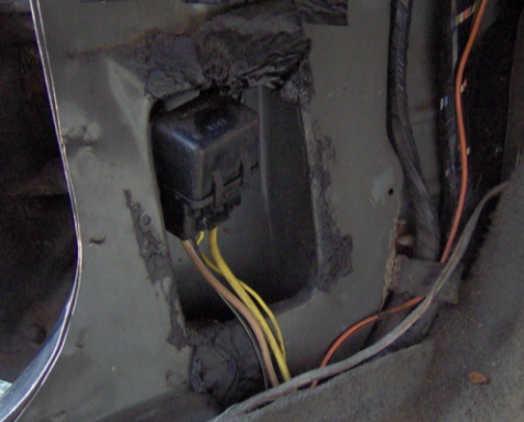

Old Apr 4, 2005 | 11:31 PM
birdofprey83's Avatar
Joined: Apr 2001
Posts: 129
From: Denver, CO
Car: 1989 Firebird
Engine: 2.8
Relay Gone!?!
Well this is where the starter relay is supposed to be right?
Old Apr 5, 2005 | 04:18 PM
91GTABird's Avatar
Joined: Aug 2001
Posts: 972
From: Memphis, Tn
Car: 92' RS
Engine: 357
Transmission: TH350
Axle/Gears: 4.10
Yes. And that was the original connector. Someone obviously bypassed it.

But here is the pic of my starter enable relay a.k.a. Theft Deterent Relay.
I ahve a few more if you need them.
