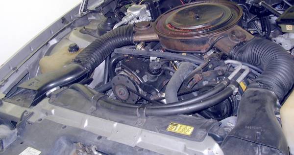

My car came with the compressor pulled out so I'm not sure what it should look like as far as mounting brackets and bolt heads, etc. A nice clear picture would be wonderful. Thanks!

Heres a few pics I took of my friends car tonight. Hope they help.

Mine's a TPI 305, must be a different setup since my alternator is on the left side.

In the '88 model year they went to the serpentine belt system and the alternator & AC switched sides.
'86 & '87 had a mix of V-belts for AC, PS & A.I.R., and a flat multi-groove belt for the alternator. Both the AC & alt belts go around the the water pump pulley. Carb & TPI had the same setup.
I'm not sure how much it would help, but there are a bunch of pictures posted on the Carb forum https://www.thirdgen.org/techbb2/sho...hreadid=183568 . Several of them are '86-'87, but probably aren't close up or detailed enough to answer your question. And, my digital camera is on the blink, so I can't go take any to help you out.
