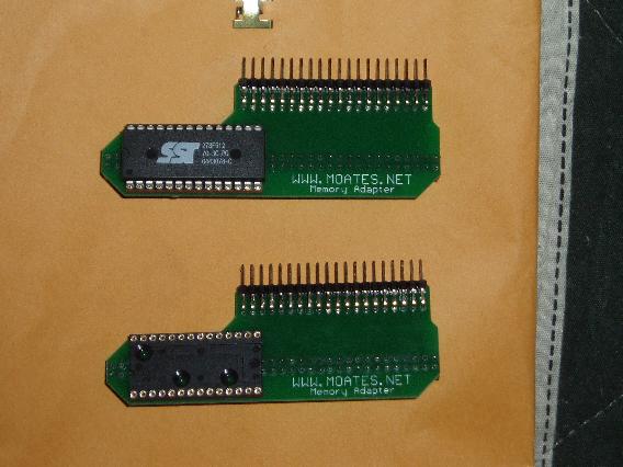

i got it today, and it looks the same as my chip, just my chip has a little square thing on it like 3/4" x 1/2" that says SST on it...but the main thing itself both says memory adapter on it...is it possible that PCMforless just gave me a memory adapter too..if so am i all set? i thought what i was ordering was that blue plastic stuff in the picture...do i need that??

here's a pic, they are identical units except the top on has that little sst thing on it....

Ok,
It seems you ordered another adaptor. If I had pictures of just an eeprom or if you had a picture of what you already had, I wouldn't have had you order that.
I'll tell you what, I'll buy that adaptor from you since it was partially my fault for having you order it.
PM me the total and I'll send out a money order to you on Tuesday.
The chip with SST is the eeprom, which I thought is the only thing you had.
