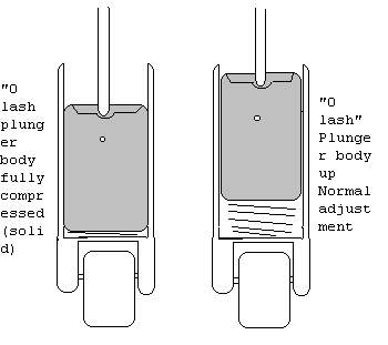

You're fine. its just the excess oil bleeding out of the lifters after you rotate the motor over. As long as the lifters are set at 0 lash with the lifter on the base circle of each lobe and then a little preload .030" to .060" before initial fireing , you're fine. just make sure that the pushrod is properly seated on the lifter and the rocker is not cocked when you adjust the lash.
Sometimes, when adding the .5 to 1 turn of lifter preload, the vlave spring compressess instead of the lifter plunger compressing (execess oil in the lifter) then once the excess oil has a chance to bleed out of the lifter, the adjustment seems slack. Once you fire the motor up the lash will go away.
If you keep going back and readjusting the lash and preload because you thnk its done wrong, you eventually completely
depress the plunger in the lifter, bottoming it out resulting in a solid stack and a open valve with no cylinder compression.
Your lash adjustment method based on 2 crank positions is ok for a stock type short duration cam but can lead to misadjustment on a long duration hi performance cam.

My LG4 is completely stock, except for a carb and intake which wouldn't make a difference right? Nonetheless, I DID NOT re-tighten any of the rocker arms.
I followed the manuals directions, and like I said, after going from TDC in the #1 position to TDC in the #6 position, the valves I tightened in the #1 position were really loose.
But I started it up and there is lots of chatter . I think I screwed up somewhere. I let it run for a little while, and the chatter hasen't went away.

ya must of screwed up then. Start over.
You're much less likely to mess up using my method.
Give it a try.
