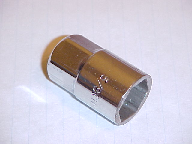

Old Jul 12, 2005 | 06:14 PM
iceman02's Avatar
Posts: 732
From: waco, tx
Car: 91Z28 L98
Engine: HSR 350
Transmission: Goebel 700R4
Here's a Craftsman plug socket I bought for $4 and cut it shorter, then drilled out the end (where the ratchet goes). May or may not work depending on how much clearance there is between your header tube and spark plug.
