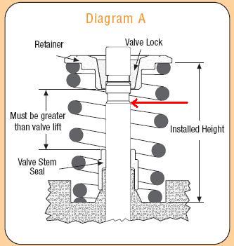

Most of the seals listed there would require machining of the valve guide boss. You can't force a seal designed for .530" over a boss that is closer to .562"

yea, the ones that I got from the parts store must be to small. This pic shows where they get stuck. I need to just get a precision measuring tool rather then wasting money the wrong parts...

Ok I think I just found the answer to my problem. Near the botton of this article it explains how its safe to use the viton seals in place of factory nylon seals. They say that the vitons can hold up to heats of 450 degrees as the cylinder head often raises about 300 degrees. My valve stems must be oversized by a small bit because the fel-pro SS 72526 seals do not fit.
What engine do you have?
According to PartAmerica.com 72526 and 72527 should fit. I used 72527 on both intake and exhaust.

Make sure you apply some oil to the insides of the valve seals and the valve stems themselves. That will help them slide down.

yea, your right, they "should" have fit. Its a stock 305 that came from an 89 RS Camaro, same L03 that was originally in the 89 bird. The engine was said to of been rebuilt by the dude who sold it to me. The intake/viton fit prefectly but the exhaust valve seals cracked no matter how lightly I put them on or with oil on the valve stem. I said screw it and put the 400 degree viton seals on intake and exhaust. On fel-pro's website they did have a car as an example of where they had to use viton on both intake and exhaust, it posed no problem since they can withstand high temps. If they give me anymore problems I'm going with my next upcoming solution that will fix many problems, the 350 swap.
