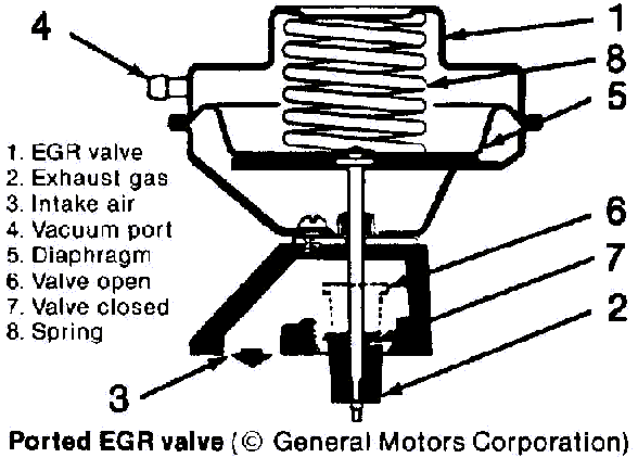

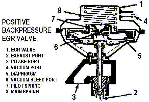

In essence, you have one of these, which may not be the same as the original valve:

Thanks Vader, you always have the cool diagrams....
