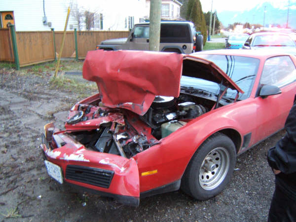

Here is some pictures
Attached Thumbnails Will a crash kill an engine/tranny?-drivers-side.jpg
Old Jan 28, 2006 | 11:45 PM
TABANDIT's Avatar
Posts: 61
From: Chilliwack,B.C., Canada
Car: 1987 Transam
Engine: 1991 350 Bored .030 over
Transmission: TH350 w/stage 2 shift kit
And this one
Attached Thumbnails Will a crash kill an engine/tranny?-drivers-side-2.jpg
Old Jan 28, 2006 | 11:48 PM
Vader's Avatar
Posts: 19,691
Likes: 320
I think mabe you could massage that ripple out of the hood, throw a little filler on the fascia, shoot it, and be good to go. Or, not.
The engine should be fine. Is the battery intact? Can you still crank it? Watch for fan and balancer interference.

My battery is still intact, my stereo and light were still going anyways. I can not start the engine until I pull or cut the front end away from it, the rad came so far back that it bent my fan, I had one of those flex fans on it, and I believe that it also bent my altenator bracket, it looked like it anyways.

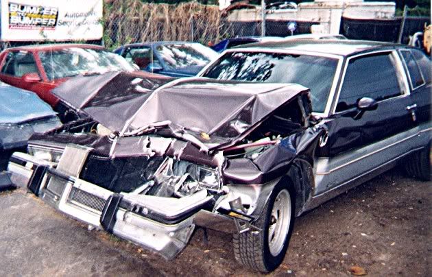

I used to own a 1987 Pontiac Grand Prix that originally contained the motor that is now in my thirdgen....I wrecked the car by rear ending a cherokee at 60 mph.....(his fault..pulled out infron of me and i nearly t boned him) the radiator was gone..the fan was wrecked..and i even cracked the water pump housing...but after taking the motor out of the car(before the insurance company could look at it...through an old v6 in it and crunched it back up against a tree) all I had to do was replace the water pump and fan and rad and was good to go...no problems ever since....
my camaro is in the background..before i even owned it...weird..lol
