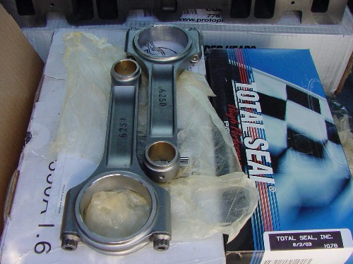

If I were building a long rod 327, I'd go this route. Search ebay for a factory forged large journal 327. I bought two for under $150 shipped, one as recently as 5 months ago. Have it magged, and turned. You can have a .010 x .010 fresh cut steel forged crank for $300 or so, if you shop wisely. Then grab a set of 610 grams 6.25" ultra light rods from http://www.dyno-flo.com
These are good for 600 hp and are an amazing $379.00 plus shipping.
You can then use off-the-shelf 383 pistons originally meant for a 6" rod. For your horsepower range and budget, a good hyperutectic like the skirt coated Sealed Power pistons. You can use any 4-bolt main 350 block with this combo.
I went this route with a 400 block except I'm using 406 piston originally for 6" rod. The result was everything I hoped. Good Luck!

To be honest, I haven't been to their site in a while. I did ask Scot Slotten, the head honcho at Dyno-flo about the torque of the cap screw ARP wave-loc bolts that came on mine and if they had another set I could buy. I sent him a picture of my rods but they didn't attach for some reason. Anyway, this is his reply:
hi, the tq on the rods is 63#, the picture did not come through, but it sounds like a 610 grams 6.25" ultra light rod we carry. these are still available for the sbc dimensions for 379.00 per set + 20.00 shipping to the
48 states. thanks scot
Attached is a picture of mine.
