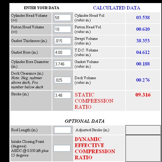

according to:
https://www.thirdgen.org/tech-data
your '89 305 TPI motor had 9.3:1 CR, my guess is that GM spec'd the parts as in my attached .jpg file, to get that CR.
to answer your original question, I imagine you want new pistons since you have worn out rings, etc? I wouldn't bother getting a 305 rebored, when you could do a 350, but if you really had your heart set on it, then flat tops with 5ccs volume, and .045" deck height would probably be the result, along with a .030" overbore. Unless your cylinders are ok, then you could just run a bottle hone through, and put in stock size pistons and new rings.....
