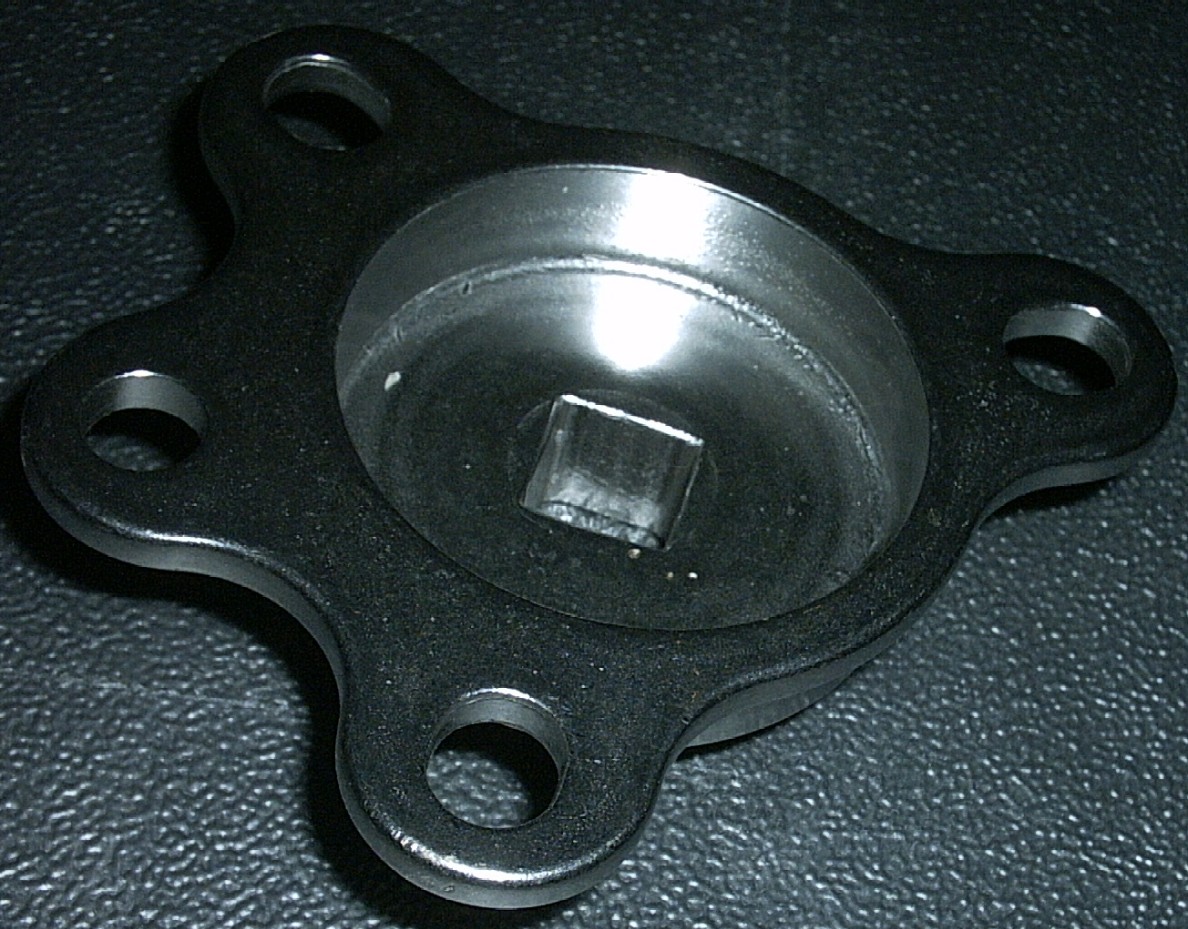

I'm thinking about getting a rotation tool like this... From the looks I'd have to remove the balancer bolt each time to install the adapter.

The one you list will work fine. It attaches to the damper itself. So you will have to remove the crank pulley (if it's on), then bolt the tool to the balancer with the 3 perimeter bolts.
On my 400, I used the crank snout socket.

I wonder why they don't make one that bolts on, permanetely holding the pulley on with slightly longer bolts? If they did wouldn't it look like the picture? It looks like they made room inside it for the thick washer that holds the damper on.
Just bolt the pulley on with it and leave it.

You could probably do that with that one.... might have to grind a bit off the outside of those ears, just so it would go down into the pulley.

I actually thought about taking an old pulley and cutting out the center of it (I have 2 spares), then going to the tools section at the local store and buying a large deep socket to fit over the center bolt. Then once I actually looked at my setup I kind doubt it would clear the balancer bolt, the one ARP gives with extra large washer. It nearly touches the pulley bolts already.
I should have also mentioned I'm running a 3 piece clear coated underdrive pulley set.
I guess I'll be ordering the proform tool next week or so. I'll get back to you guys with the updates and also a picture from the backside. Seems like everywhere on the net only shows the face of it.

That would be great. Since you still have the stock serpentine pulley, post a pic of the adapter "in place" in the pulley and one showing the stock washer in the backside. I could certainly use that setup if it'll work.

i used that rotation tool and did not take the pulley off. The bolts were long enough to go through both. No problem.

Only problem I might see from it being left on the pulley all the time is additional stress on the harmonic balancer. That tool is not perfectly balanced and would definitely cause extra weight to the snout and to one side of balancer all the time. If it was a stock motor I don't think I would mind leaving it on there. But since I plan on turning 7,000+ RPMs I think I'll pass, and just remove the bolts every acouple oil changes to do lash. I'd rather take a little more time than chance at messing up my $8000 motor swap project.
I plan on ordering this next week so I will get back to you guys with pics of it in a stock serpentine pulley.

Part came in and yes it does fit inside the OEM pulley. It might fit inside the March Performance Pulley, but it's hard to tell with it on the car. It would definitely be a tight fit.
And this does NOT fit an ARP balancer bolt. The washer and head of the bolt are simply to thick. So you would have to remove the bolt and pulley bolts to install this, which would make it easier just to remove the pulley also if you use an ARP bolt.
