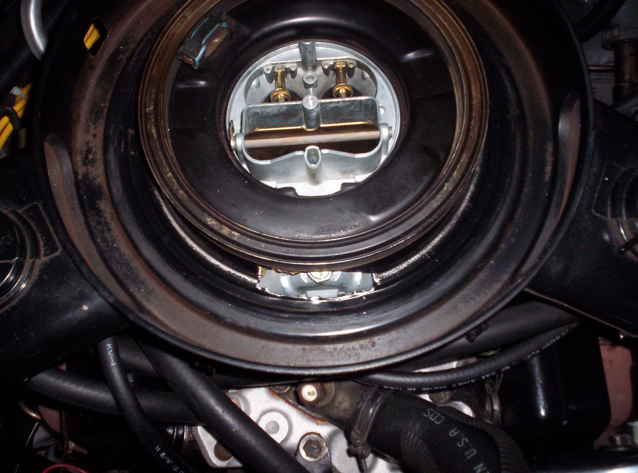

heres what i did to the breather.all you have to do is cut holes for the fuel lever adjustments to make it sit right down on the carb

heres one with it all together,and i never got a chance to paint the cover.in the other pic you can see how snug it fits onto the carb now

I kinda don't get the one pic.
Why have dual snorkles but have the lid spaced up like an open element filter???

well i don't have it all finished yet.i just got it to clear,that was my main project.i still have to clean up the cuts on the bottom peice of the breather and for the cover,bend the edges down to fit snug to each other.the main thing is that i got it to fit under the hood.
