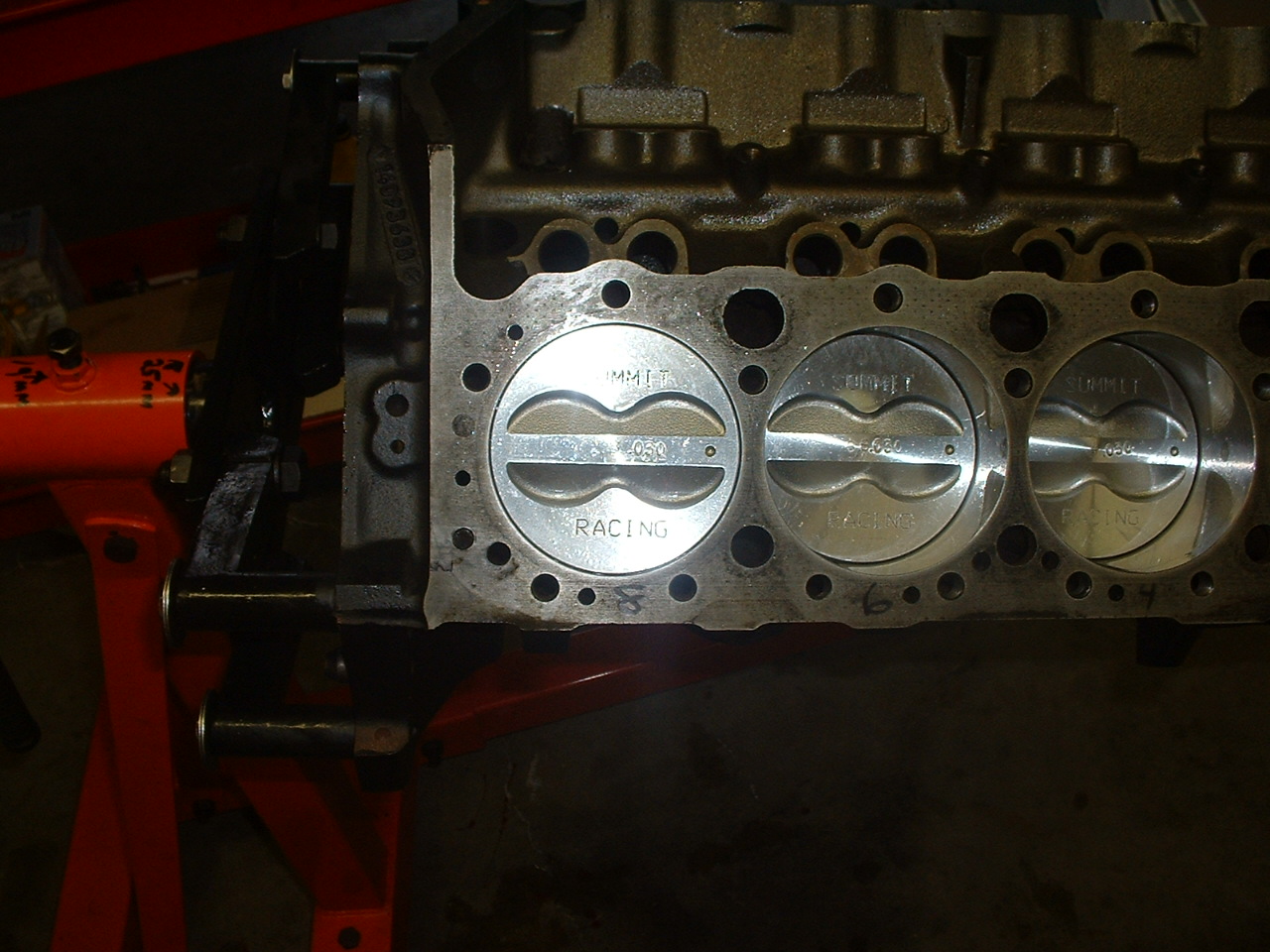

If you follow the number eight piston up the china wall the set of numbers you see right behind the wall is the block casting numbers, see if this picture helps.
Attached Thumbnails correct block numbers for an '87 l98.-number-eight-piston-installed.jpg

allright thanks for the help, im going to jack up the trans first chance i get to see if i can get a better view of the back of the block. this really threw me for a loop because in the past the number i have used to identify a block has always been on the driver side inline with the dizzy, as it is on the 350 4 bolt main i have in the barn, however its been awhille and as usual my memory is suspect for the error. ill get back on soon as ai have more info and thanks for the effort
