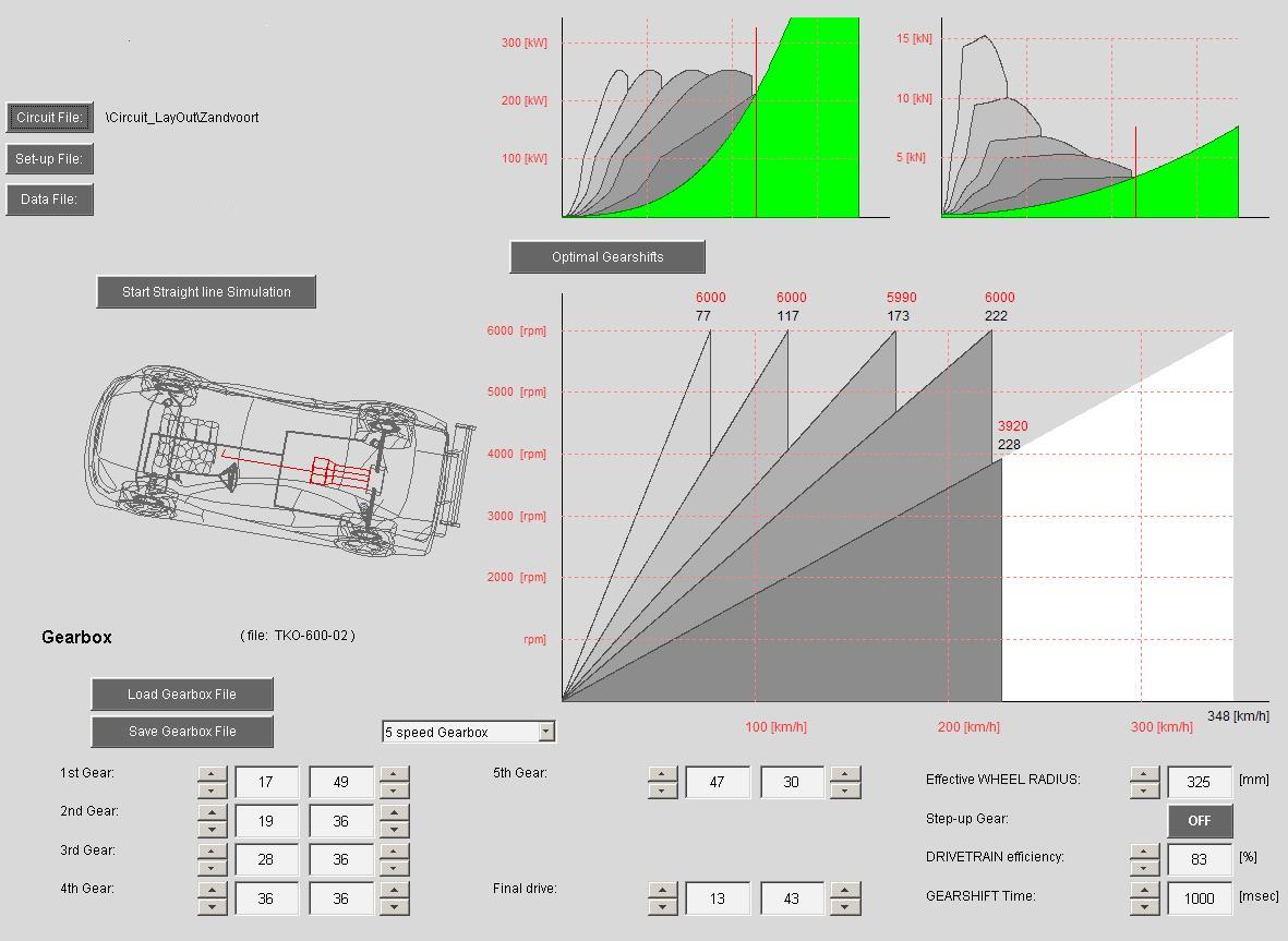

I use to drive at the circuit and there we need to have the best RPM shift possible so that we don't drop to much the RPM outside the power band.
According a simulation software (See picture) it advice to shift at 6000 rpm to keep the engine above the 4000 rpm (max. torque) but this software don't take in account the RPM capabilities of the engine.
I was thinking to at the safe side and shift at 5800 rpm but 6000 would be better according the software.
Do you think that I take a risk if I put at the EPROM a max. of 6000 rpm?

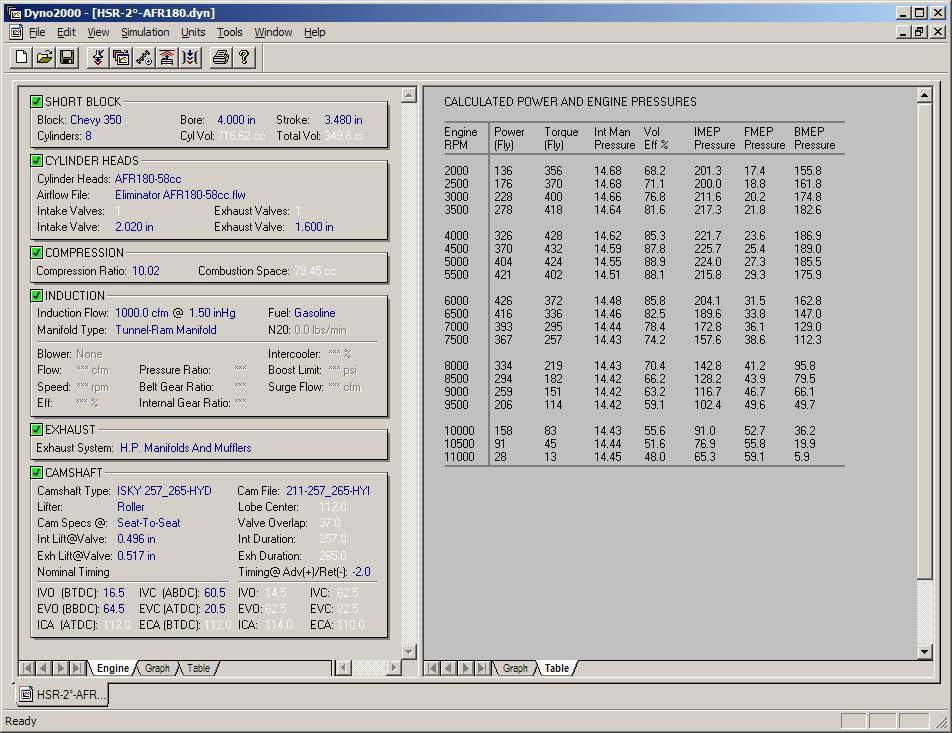

Like I say the figures mentioned are from the "Engine Analyzer Pro v3.5" trial version check here the attachment, please if you have the time, let me know if I make mistakes with the input values.
The torque output with DD2000 is much lower than the 496 ft lb. DD2000 calculates with 432 ft lb at 4500 rpm I don't know why?
Some one told here that "Engine Analyzer" was better but probably I make some mistakes with the input.
It is a huge difference but I will be happy with something in between.
At a road track course the engine power band is very important because we need to put the torque on the asphalt and the limiting factor become the tires, to much torque an bas selected differential ratio and you need to learn again how to take the turns, a bit to early with the right foot and you are gone.
So I am not looking for a top end drag race car with lots of torque, but just a smooth working, with very fast rev. engine.
I did estimate a working area of 3200 till 5800 rpm and I hope that the parts selected will fit the purposes.
