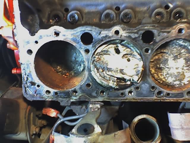

Allright, well, I was over at my bro's house last night working on his 'Vette. We finally got the driver's side head off and it was the worst possible case scenario. The #3 exhaust valve broke, bent the #3 intake valve pretty bad, cracked the head, put a couple holes in the combustion chamber. So the head was junk.
Then we saw what was left of the piston. Two holes in the piston and it was broken into about a dozen pieces. Got all that crap out and the block was wasted too, along with the wrist pin and that connecting rod. The engine is still in the car, where it will remain until my brother can afford a completely new engine.
You hate to see this, but I couldn't help getting at least one pic to share w/ you guys. Sorry its a crappy cell-phone pic.
dave
dave

You absolutely sure the block is junk, can it be bored to clean up? You mentioned in another post about how your brother was concerned with a numbers matching car, if you change the block, it will not be numbers matching and devalue the car significantly, especially since it's a Corvette (found this out the hard way years ago). You can change everything else and keep the current block and have it machined would be the optimal choice, if not do your best bet is to find a good block with the same casting numbers for originality.
Re: Need help with my Brother's Vette
Well, That's done....My advise, take the engine out of the car, get what you can sell or use off the engine and build a new one. Fact is, that engine is going to cost you a lot more time and money to repair then the ADDED re-sell value of the car will bring with the correct casting numbers. In other words, an old car with a new engine..worth $$,$$$ Minus your cost to replace.An old car with a totally rebuilt engine...worth. $$,$$$, Minus your cost to re build. And honestly, if your planning on keeping the car, racing it, you'll better off. I know the numbers the numbers. Always buy new parts you'll be money ahead in the long run.

Oh, the block is destroyed, that cylinder was shattered almost as bad as the piston. Didn't even find all the parts of the cylinder wall, I think some chunks went down into the oil pan.
I know he wants to keep the car, he's dreamed of owning a Stingray since he was a kid. Racing it, no. This car is pristine except for the engine, very nicely kept survivor with 71k original miles.
He just had a baby, so money is tight right now. We were talking last night and think he's gonna look for like a junkyard motor for now just so he can drive the car, then as time and money allow look for a good block with the correct casting numbers to get the car back to original.
