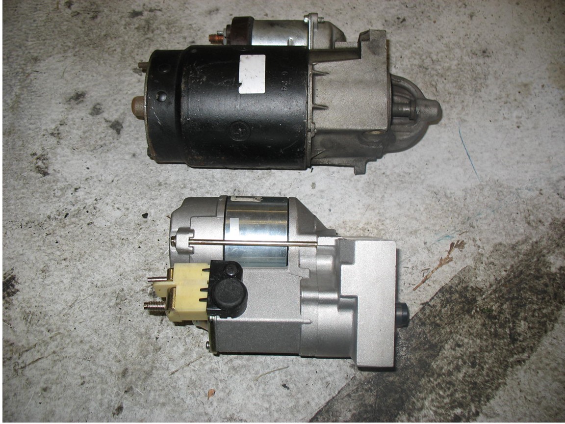

Here is a pic that RAD5 posted that compares the L98 and the vette starter in size.
https://www.thirdgen.org/forums/atta...de-start01.jpg
I would like to see a pic of the 89 vette style and the Lt1 side by side to compare. Although the 89 style isnt as small as the LT1, it still should be a good upgrade right?

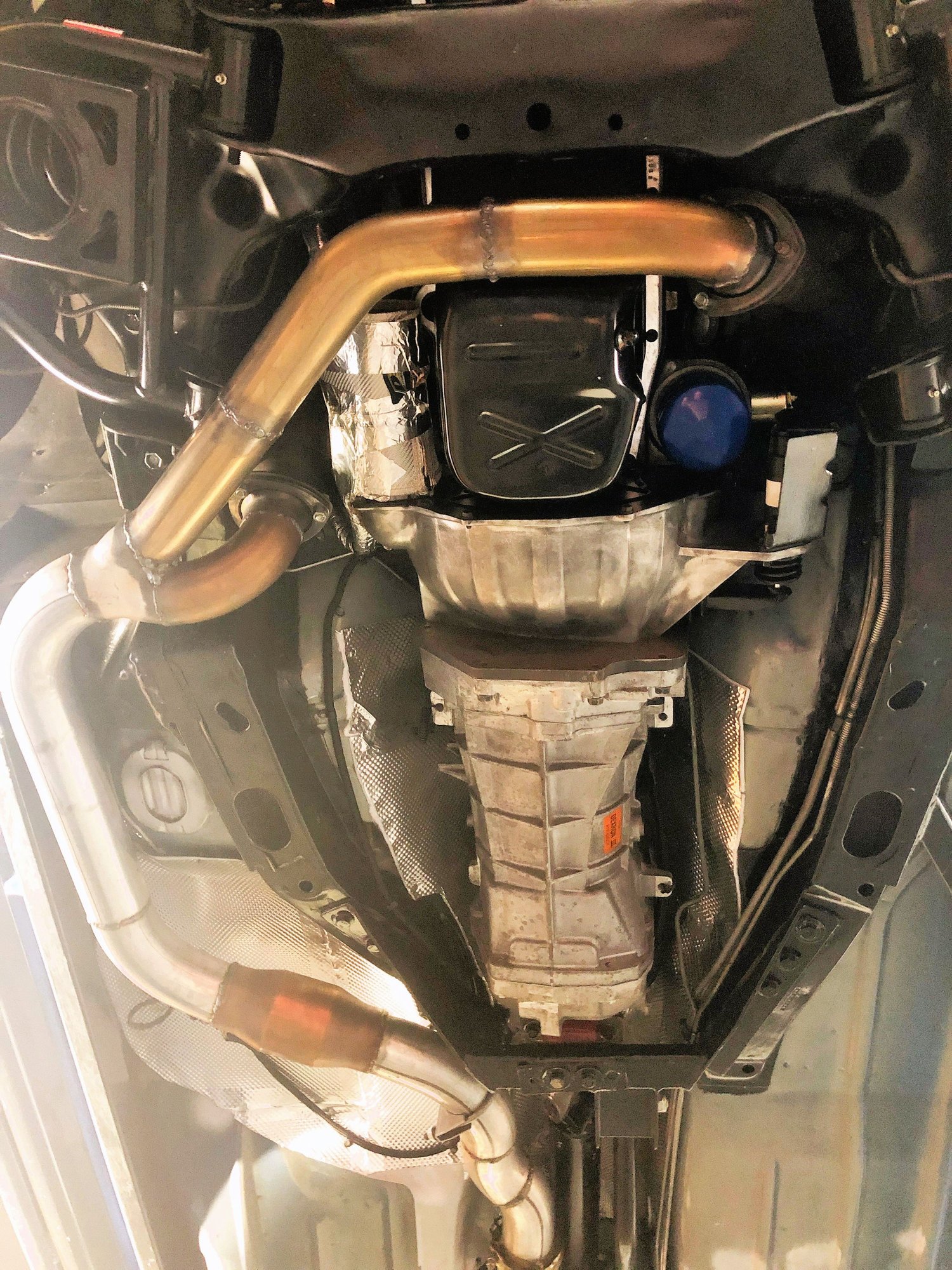

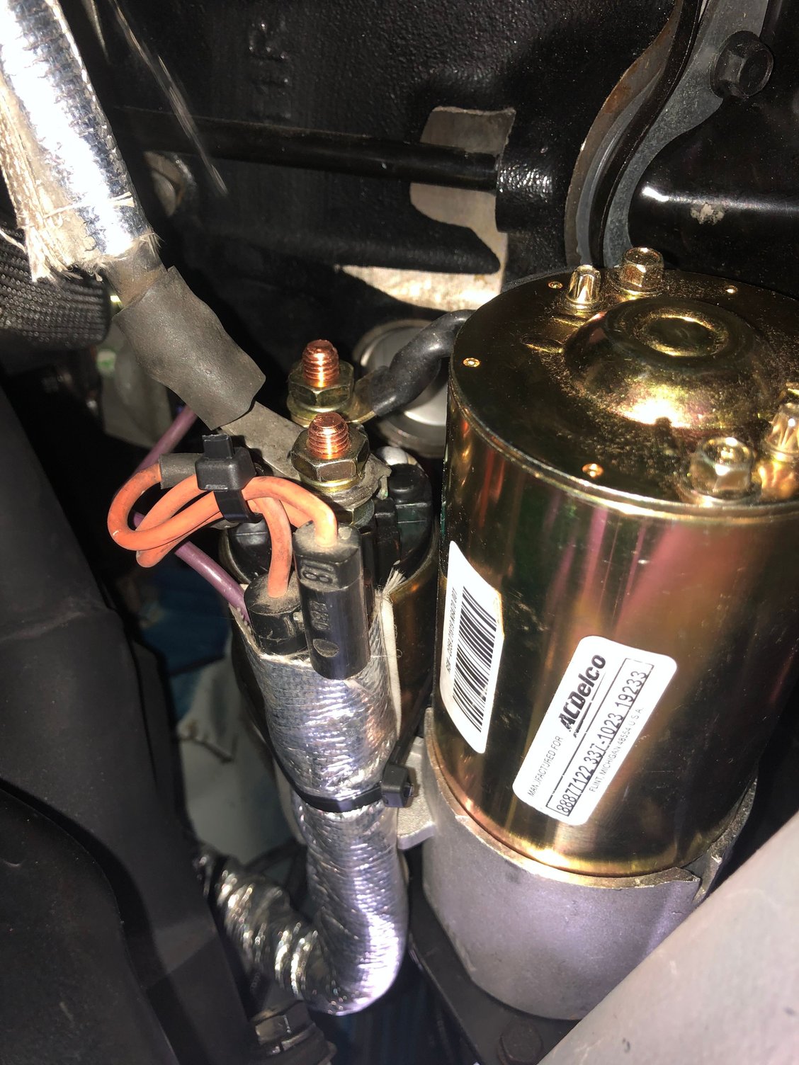

Thought I would revive an old thread since I had to go through them recently to select a new starter for my 383. I was using my old OEM that came with my 1991 LB9 engine. Here's what I found that would fit the small block:
ACDELCO# / Power Rating / Model-Year
3361580A / 1.4kw / F-Body 93-94-Caprice 94-95-Impala 94-95
323480 / 1.7kw / F-Body 93-94-Caprice 94-95-Impala 94-95
3361913A / 1.7kw / F-Body 95-97-Caprice 96-Impala 96
323488 / 1.7kw / F-Body 95-97-Caprice 96-Impala 96
3371023 /1.7kw / F-Body 95-97-Caprice 96-Impala 96
3361054 / 1.4kw / Corvette 88-91
3361148 / 1.4kw / Corvette 92-96
10455709 / U/K / Corvette 88-96
The Corvette models are different than the F-Body/Caprice&Impala. However, they are ALL offset gear reduction. It will fit automatic or manual 153 teeth.
I got the #3371023 because it was the cheapest and most recent model. Also, it was a NEW unit, not remanufactured, and came with new bolts. It installed under 30 minutes (with Hoist!) and cranked like a charm. Much smaller than OEM. It does have a more modern sound, kinda like a motorcycle. I absolutely love it. All my problems of long cranking while cold are gone. The old OEM starter was taking 6-7 seconds to get the engine to over 300 rpm when cold. That was delaying the ECM from activating the injectors. The old starter came out without having to undo the exhaust Y pipe... Was probably lucky! BTW my 383 has 9.7:1 compression.
