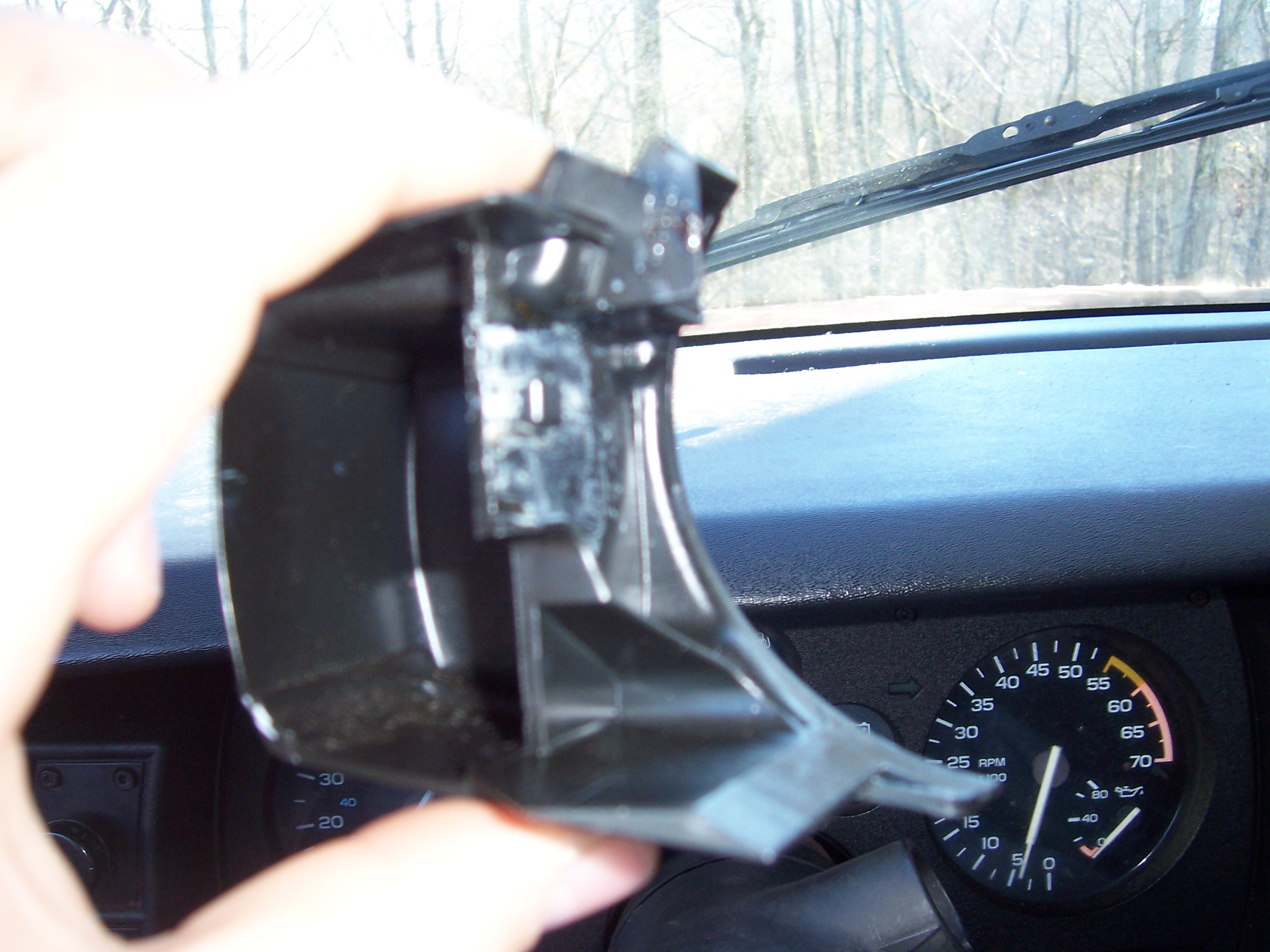

Ok how do all thses fit together i know that lil plasic peice slids on the cover, but where does the rod go?

can u get a pic of the rod? It's been a few years since I've had one apart..

Re: Wobbly Wheel
the rod is in the middle pic, i might have to take another one if it isnt clear

Re: Wobbly Wheel
the rod goes on the peice of the colum with the white stuff and the switch is just next to it not connected it just buts up against it as for the wiper stick thing im not sure if its connected or not

Re: Wobbly Wheel
ok so b asically its just sandwiched together?
you got er pontiac

Re: Wobbly Wheel
thanks all who helped i got it the rod fell out of the switch which made it more confusing... now if i can get the horn working lol
