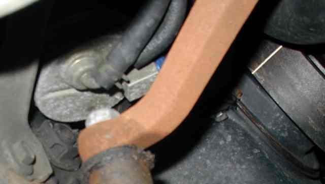

it's a 1986 camaro with a carbed 305, the fuel pump is mechanical and on the side of the engine, this is more in front, above the idler arm. unfortunately I can't get a picture untill I find someone with a digital camera. the steel lines have to be gas lines, they're the only things leading to it, one comes from the back of the car, and I can't see where the other goes (I'm assuming up to the carb in a roundabout fashion). I hope this helps, and I'll try to get a pic as soon as possible.

Look anything like this?
It's the fuel pump.
(The orange-ish thing is the idler arm....)

Sofas got it! Thanks for the pic!
