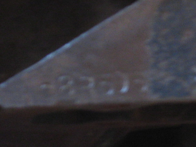

I bought a 350 block that was claimed to be from an '86 vehicle. I got it for very cheap so I grabbed it up. Now I am trying to figure out everything I can about it to make sure I want to use it.
There is a lot of rust/wear on the block, but I was able to find a few things. I found the "GM 5.7LG SGI" stamp, and I found a number on the front of the block (passenger side), but it is very hard to read (looks like C88506). I also found the (I hope) date code with engine code suffix (V05028AN).
Only problem is, I cannot find anything about these codes. I figure the engine was from Flint, and was cast on May 2nd. I cannot find the suffix "8AN" anywhere though.
Attached is pictures of the block. I tried to get a picture of the "C88506" code I found, but it came out blurry because my camera sucks at up close pictures. I did not get a picture of the date code and engine suffix, though it was in VERY good condition and I am pretty sure it is right (99% sure). I was unable to find the casting number on the block.
Can anyone offer some help?

That's a "638" block, one-piece rear main seal, roller lifters. Can't see if it's 4-bolt main - was used both ways.
A very common and good block. Used in passenger cars, performance cars, trucks, and crate engines (it's the block I have in the Camaro).
It's '87-later, so if it came out of an '86 vehicle, it was either a very late '86 production, or a replacement engine. "May 2nd" would indicate it's a replacement engine.

Wow, you can tell that just by the "638" on the block? Where exactly is the casting number? I couldnt find it (I am assuming it's imprinted and not stamped like the 638?). Though I didnt know the date code/engine suffix was where it is either, so I'm sure I may have missed it.
Old Feb 24, 2008 | 08:50 AM
Posts: 27,918
Likes: 2,448
Re: Need help identifying 350 block
Castings are normally referred to by the last 3 digits of their casting number. That's what "638" is.... the last 3 of the casting number of a very common 87-up 350 block, found in all sorts of 350s. On blocks, the last 3 are usually cast into it in a couple of different places, as well as of course the complete number in one place.
The complete number is located here.
Behind the driver's side head, on top of the bell housing flange.
The stampings will tell you a good bit about the engine that the block was originally built into. It may or may not tell you anything AT ALL about the motor that it is now, however. Once a motor has been "rebuilt", most of its resemblance to its original configuration, disappears. However, the stamping will tell you what size motor it was (305, 350, etc.), IF you know the year of it (they re-used stamping codes sometimes after a number of years), which is useful.

Roller block - very good.
Get a picture of the lifter valley for us please? Then we'll know if it's been drilled/tapped for roller lifters. (i'm not sure if this is a one of the ones that may/may-not have been).
Then remove the rest of the plugs from the block, and take it into a machine shop for a hot tank ($40) and a magnaflux ($40). Find out if it's useable. If there's rust on the main cap bearing surfaces then it may need an align hone (extra $150 or so).
But I think it's still a usable block. Have the machine shop measure the bores for you now, to see if it's a virgin bore or not, and find out what size it'll need to be bored out to.
Then you can look at pistons, rings, rods, crank etc etc etc.

Since the cam retainer plate area has been drilled & tapped, the rest probably has been as well. But, should be easy enough to verify.
I'm wondering why those cam bearing webs have been painted. Makes me wonder if it's cracked there. Not a common place for cracks, but suspicious.
The paint marking says "350 L". So, it probably came out of a light truck. Doesn't much matter, as sofa has so thoroughly pointed out (it's a bare block - what used to be in/on it is moot). 2- vs. 4-bolt is about the only detail left to be determined, and that's a matter of looking. And doesn't make much difference, anyway.
