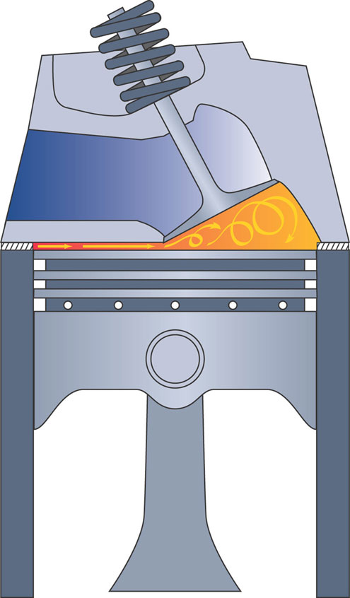

Squish, quench, piston to head clearance. All the same thing.
LOw squish does wonders, alot of people over look this little detail.
Squish makes power, squish makes higher cr's safer, squish increases mpg, squish reduces detonation.
How does this so seeming simple little thing do so many feats?
Simple, better mixing of the air fuel charge. A better mixed af charge burns more in a more controlled manner, burns more completely.
study the pic below
As the piston come to tdc compression, all the air fuel charge thats on the left will be squirted or squeezed into the combustion chamber on the right. This action will cause the af charge to swirl, mixing the af charge. Now the smaller the squish clearance the faster the af charge is squirted into the combustion chamber. This will cause the af in the chamber to swirl faster, mixing it better.
