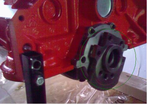

I just got my 383 from T&L Engines. This is my first engine build. Theres something on this engine that wasn't on my L98.
This is probably a stupid question..What is it? The engine is a 383/6" rods/internal balance. At least according to the invoice.

thats the end of your crank shaft.

Well, yeah.. It just looks different than the L98 somehow. Maybe it has just been that long since I tore it down.

The reason it looks different is that is a two-piece RMS crankshaft. I believe your original '88 crank was a 1-pc RMS setup. Which had the back end of the crank as a round stub.
If this is true (orig was 1-pc) then a different flywheel or flex-plate will be required. The bolt hole locations are different between the 1-pc & 2-pc cranks.

That would explain it... dang it. Suggested part #'s for an oil pan and flex plate anyone?
Wait a sec... The casting number on the block is 14093638
14093638...350...87-95...2 or 4...Roller or flat tappet cam, one-piece rear seal (mortec)

Looks like a one piece RMS block with a 2 piece RMS conversion and crankshaft.
Pre 86ish oil pan with passenger side dipstick
Since it's internally balanced, pre 86ish flexplate for a 350.
When in doubt, contact the builder instead of guessing in case you guess wrong.

Why would they do that? Any valid reason?

my engine is the same way, its a roller block with a 2pc rear main conversion. There are more options for the 2pc cranks than 1pc ones. Just give them a call, im sure they will be happy to answer this question for you, I found them very helpful.
for example, i just flipped to the cranks page in my trusty jegs catalog and found 2, 1pc cranks and 23+, 2 pc cranks

They should have said they were using a 2-piece RMS crank. There are plenty of 1-piece RMS 383 crank choices now, unless this is something really wild.
If they didn't specifically say they were sending you an engine with a 2-piece RMS crank, they should provide the flexplate you need.

I guess I am equally guilty of not asking. I asked if it was a roller block. The answer was yes. I left it at that. My stupidity really..
I'll just track down a flexplate. Still not sure about the oil pan.
Will this flexplate work?

Just heard back from T&L. Good news about the oil pan actually.
"The block is a one piece rear main seal, however, we use an adapter on the rear to accept a 2 piece rear seal crank. The adapter is setup to accept the 87 up oil pan so you will be fine there. The flexplate will need to be changed however. We offer a SFI flexplate for $69 plus shipping."
